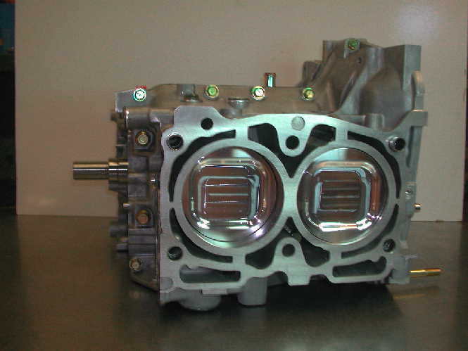

With the help of our engine builder, Crawford Performance, we can now get the new 2.5 STI block to work with USDM WRX heads. We keep the STi turbo crank and rods and use special forged Crawford pistons. These Crawford pistons keep the proper compression ratios that the wrx heads need to operate effectively. Without specially designed pistons…the STI block will not work with the wrx heads.

Here is a photo: sorry it's a little blurry.
https://www.i-club.com/forums/attach...&postid=225896
JohnQGearhead - yes the pistons are ceramic coated. As for the price of the short block. Well, that depends on which dealer, rep you get your parts from. Right now, this short block is not an easy piece to get.

JohnQGearhead - Sorry not to answer your previous question.
"I would be VERY interested if I could fit phase II 2.5 heads on the STI shortblock(for later turbo)."
The answer is yes. We can have pistons made for that setup.
