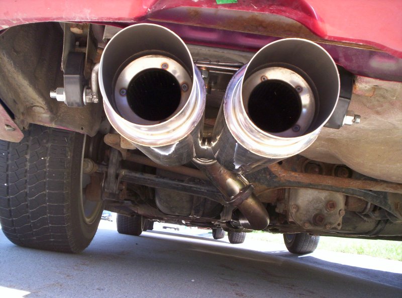

Old Aug 18, 2005 | 09:48 PM
cudaeh's Avatar
Posts: 989
Car Info: 2000 impreza 2.5 rs
Originally Posted by Crashmaxx
Its not a cat back, the stock cat back has a flange halfway in it, right by the axle. So an axle back is the muffler to the axle flange, but not the piece from there to the cat. But you can usually get that part later if you'd like.
I just love visuals.. the axle back stops at the flang welded to the muffler pipe.

More pics for you to reference. These are STI and WRX axlebacks. Essentially just the muffler and piping to where it bolts to the end of the midpipe (as explained already).
Bosal axleback and midpipe:
Prodrive axleback:
All pics came from the Reviews section...FYI
...and one more thing, in case you want to know what cat-back or turbo-back is. This is from COBB Tuning's website illustrating the WRX exhaust system:

I have never stept foot in a 'ricer store' and seen any thing other than universal parts... except for healight covers, taillights, and body kits that is. Usualy they are just selling the mufflers wtich you would need to weld on an adaptor and clap on the muffler (stainlees dont weld to good) to your axle back in place of the stock muffler .... like i did
by far an axle back section is much cleaner looking.
