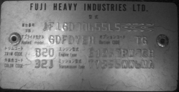

Is the chassis code anyway related to the VIN?
My USDM 05 STi lists GD7 in the VIN (digits 4-7).
G = Car line/Impreza
D = Body Type/4 Door Sedan
7 = Grade/WRX-STi
So is GD7 my cars chassis code or not?

There is some duplicated information in the VIN (GD, etc), but the real chasis codes is labeled "Applied Chasis Code" on the information plate under your hood.
I don't know if they changed the code for 05 or not, but I believe the applied chasis code for the 05 is still GDB.

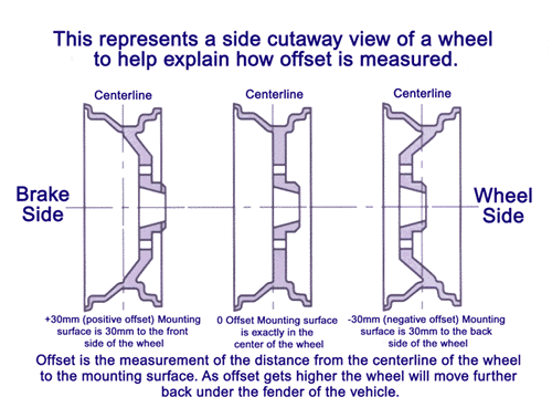

Can someone explain this any better to me? I'm still confused?!?!
Offset = The distance between a wheel's mounting surface and its horizontal center

You are correct sir. Here is a diagram to help show whats going on.

Wow thanks! your rock! Question 2.....What are the advantages and disadvantages of +/- offset, if there are any?

I wouldn't really say that there are advantages. For a specific car, you will need rims of a very specific offset, and if you vary too much, you can cause extra strain on your hubs and stuff (yeah, how's that for a technical answer).
How much offset you require is based on the car you drive, and how wide the wheel is. I don't know exact numbers off the top of my head (ask in the Tires and Wheels forum for a better answer) but, most Subaru's want 48ish to 55ish, depending on how wide the wheel is.

This is the info on my info plate under the hood near the drivers side hood hinge.
[VIN] JF1GD70655L5XXXXX
[Applied Model]GDFDYEH
[Option Code] TG
[Trim code] B20
[Engine type]EJ257BW7CH
[Color code]32J
[Transmission type]TY856WW6MA

Yeah, then you have a GDF.
D = Body Type/Sedan (specifically Bugeyes and new generation, not first gen Imprezas)
F = Grade/WRX-STi (is it F for '04 and '05 STi? I'll try and find the answer tonight)
any answers?
Old Oct 28, 2004 | 04:11 PM
  #71
Nick Koan's Avatar
Posts: 17,466
From: The BLC
Car Info: Legacy GT
Yeah, both the '04 and '05 STi are GDF.
GDB is for the EDM and JDM STi (2.0L motor) and GDF is for the USDM STi (with the 2.5L).
