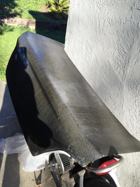

Need the best help the clear is cracked and blemished I was thinking 800 grit wet and reclear it myself. Let me know thanks
Here ya go but there are clear coat cracks

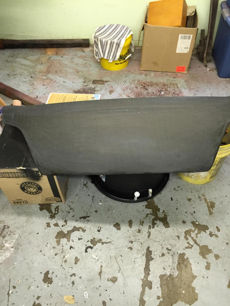

This is will 400 wet and 320 with 1000 to clean up scratches

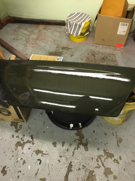

First coat of duplicolor clear
please keep updated with more pics. I need to do some cabon repair on my hood scoop and can't find any shops that know how to fix CF.

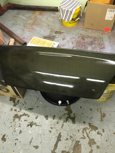

Car Info: 2006 subaru wrx tr
So far 5 cans of clear
looking good! Was this a wet or dry photo? Looks wet. Looks great.
It's just duplicolor clear in the can it's taking a lot of clear but I had to do a lot of sanding that's for sure
