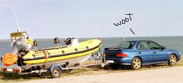

LOL thats a funny video. i wouldnt suggest hauling a boat with a wrx but what the hell.... this guy did it in his impreza!
http://www.iwoc.co.uk/images/iwocmembers/saterz.jpg

That's an rigid inflatable and probably weighs less than 1000lbs and certainly much less than 2000lbs. Also the car is probably not a sport tuned turbo model but a non smogged 2.0L which would make for a more managable towing vehicle in the low end grunt department.
Nothing wrong with towing just overloading.
