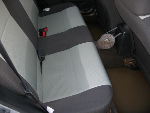

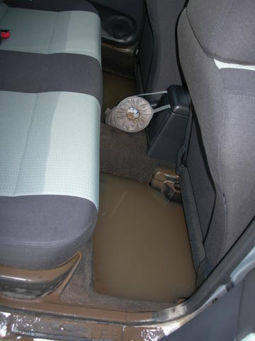

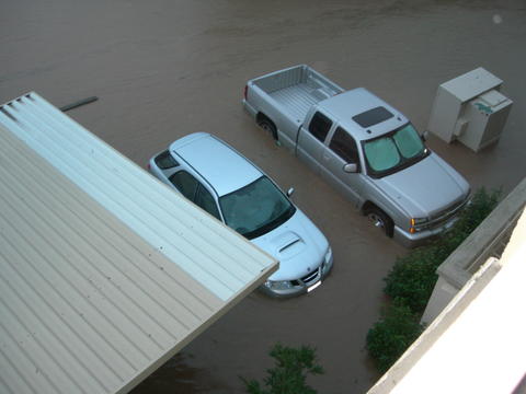

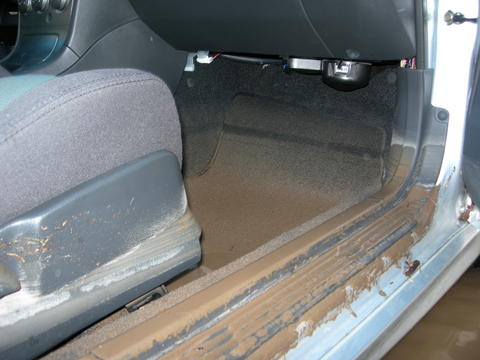

So, my 6 month old Saab 9-2X wagon was a sitting duck in the floods we just had here in Northern California. The water came about halfway up the door. Inside the car, it looks like it came to the base of the shifter, not quite up to the center console electronics. The keyless entry still works but I am afraid to try to start the car for fear of further damage. Luckily insurance said that they will fully cover any work that needs to be done, and the car will not be totalled. I am weary of taking it to an independent body shop so I was going to take it to the dealer (since insurance is covering it, the cost doesn't bother me). My questions are, what is the dealer going to do to get it back to working condition, should I be suspicious of them cutting corners, what should is important to check on the car after I get it back to make sure that I don't have any problems in the future? (rust). Any help would be great.

Disconnect the battery. It may be too late anyway but you want to interrupt all current flowing through the car. The damage to the wiring and electronics is worse when there are live circuits at the time of the flood.
The ECU is located behind the passenger footwell so it is probably damaged or destroyed.
If the car is to be repaired and not totalled, the entire interior should be stripped and everything that got wet should be replaced- seats, carpet, trim etc. Any electronics that got wet should go, and all harnesses and connectors should be inspected. Ideally the entire body harness should be replaced. One of the problems with repaired flood cars is hidden damage to wiring or electrical components that may not cause problems right away but may do so months or years later. You should insist on having as much as possible replaced, definitely everything that was below the water line.
This was presumably a fresh water flood and not salt water? If it were salt water the car should be totalled because the salt gets into everything and causes corrosion (especially any live circuits as I mentioned). Fresh water isn't nearly as bad if it's dried and repaired quickly.

I woke up at 4:30 in the morning and the water was above the bottom of the door, so I didn't open it, I was going to climb in through the back (since it wasn't above the back bumper yet) and try to drive it to higher ground, but the water rose another 1-2 feet in about 30 minutes and there wasn't really anything I could do. I hate the feeling of being helpless. Believe me, I am going to be so paranoid EVERY time it rains from now on. . .
