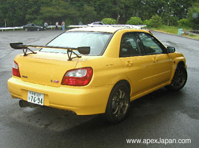

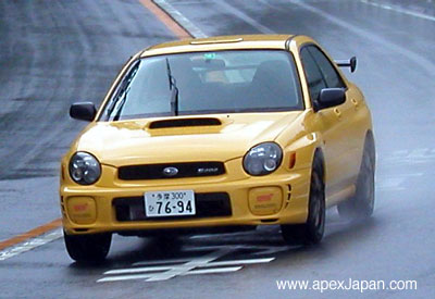

Ok so it's August 2003, and you've waited 2 years for your STI and you've had it couple of weeks, you've blown a couple of M3's and Cobra's,..AMG C32's(up to 120mph) and a host of other top contenders,..you've blow em' away.........
NOW What? do you start searching for a couple of horsepower, better handling, some PAGID RS4S pads, ??will 300 hp be enough? will a 2.5 turbo with goo-goo gobbs of torque fill the void,..Will you feel like alot of Brides after the wedding day that they planned since 4th grade?....
I have decided I will begin,..PROJECT S203,..yep,..It is rumored that STI has already started on a 2.5 version of our baby !!
Picture this,...( hazzy effect and harp sounds) ....................
white STI with platinum Rays 18 inch wheels, pink STI rear control arms, Spec C type ra front control arms that position the wheels 15 mm forward and remove ALL understeer, STI front mount oil cooler, STI braided brake lines,..WRC rear wing ( with that 3 inch overhang),Spec C front lip spoiler,Spec C springs and Ohlin struts, and last but not least,.3inch PRODRIVE exhuast with ECU modificaton( from Prodrive-USA).
........just a thought,...OPINIONS PLEASE................

S202 control arms
The S202 has the spec c-type ra control arms which moves the front wheels forward 15mm which is better than a huge caster adjustment, and makes steering input instant. Except when it's moved at the base of the pivot, its a really big deal. It also makes camber adjustments more noticable. This change was made to the "new look" spec-c type ra and every journalist that has driven the cars say the old understeering feeling is 100% gone ,making handling a big improvement. I know with my GC8 at the track even with 3 degrees front negative camber, I had to lift a little (even with a anti-lift kit) to get it to turn. Supposedly the "new look" cars have significant changes made to the front suspension geometry(my source @ Prodrive -USA says all they did was use bushings similar to and as effective as a anti-lift kit)
The good news for us in the U.S. is we will get to drive a regular WRX "new look" in mid to late March and it has the "updated front suspension geometry.
944 turbo guy
P.S. Imprezer, this would have been a good thread to start because everyone is always talking about 300hp and Brembo's, yet I think the car's real strength will be handling. Anyone who has ever had to "sort out" a car or racecar that doesnt want to turn,knows that if the front wont turn make the back turn, and the dccd will allow that for sure, the question is how many,..quote end quote,..enthusiast will are truely be quick enough to "catch " a 300 hp tail coming around with 65% rear bias?....thats the question I think about when I get a student at a drivers ed event with a 400hp modded STI with a rear sway bar the size of my arm and 65 % rear bias and cold D.O.T. sticky tires.................
ya' know what I mean??................anyway just a thought.
