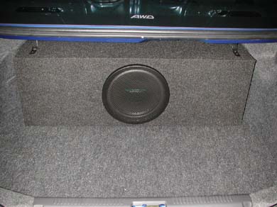

Here's mine. It's a 10" Image Dynamics Sub. More than I need. The box is built right across the back. Behind the box between the seats is a Phoenix Gold Titanium 4 channel amp. I have the pass through in my car (Canadian) and when I open it you can see the AMP with the three blue lights come on. Opening it up has no effect on how the bass sounds though.

got close up pixs of how that enclosure is mounted on the rear shelf?
is that the only way it is mounted?
