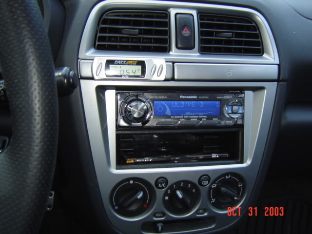

Those of you with new stereo head units, can you post pictures? What size did you use? DIN? double-DIN?
Thanks!
Old Oct 18, 2004 | 09:46 AM
AzN121184's Avatar
Posts: 6,249
From: Downtown oakland
Car Info: civic
Thanks!
most people go with aftermarket single din units. Here's a picture of the first deck i got to replace my oem deck.
