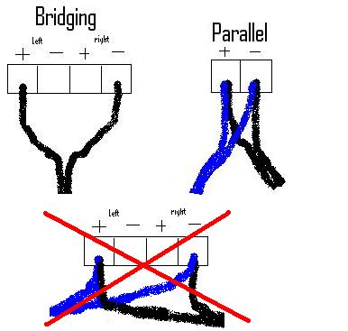

thanks guys for the info:banana: i'll just go with the JL amp. I have another question how do you bridge channels and could you give a better explaination on how to parallel wiring?

Bridging two channels together involves hooking up one wire (pos/neg) to the two channels you'd like to bridge. For instance, if you have two adjacent channels on an amp (pos, neg, pos, neg from left to right), the most common method to bridge them is to hook up the speaker wire to the positive terminal on the left channel and the negative terminal on the right (or whichever are on the outside). Most amps say specifically how to bridge channels right on them, but this is the only way I've seen. Parallel wiring is just hooking up two speaker wires to one channel; two wires in each terminal. Both bridging and parallel wiring cuts the impedance in half, so combining the two methods is how you blow channels, unless your amp is 1ohm stable. If you do this, it will work temporarily, but not for long. Oh, also, both of these methods alone change the signal from stereo to mono, which is not desireable unless you are running subwoofers, or if you simply dont have enough channels to run all of your speakers and must run them parallel. Heres a pic for you visual learners

SWEEEET!! thanks a bunch. I had two kenwood subs and the acoustick amp 2ch and i was about to parallel both subs and bridge it but i remember my friend doing that and his fuse got burnt.
so I decided not to do it.
