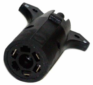

Got to a trailer supply store and get the big 7 pin trailer hitch connector. The center pin is large enough for an 8awg power wire, the rest can be used for signal and woofer connection.
Signal can be disconnected with rca cable (if using the line input). If there are hi-level connections you may just be able to unplug thoses as well (depending on the amplifier).
Here are some images of the plug.
Attached Thumbnails subwoofer and amp setup-7way.bmp   subwoofer and amp setup-trailer-plug.gif
