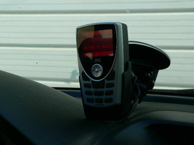

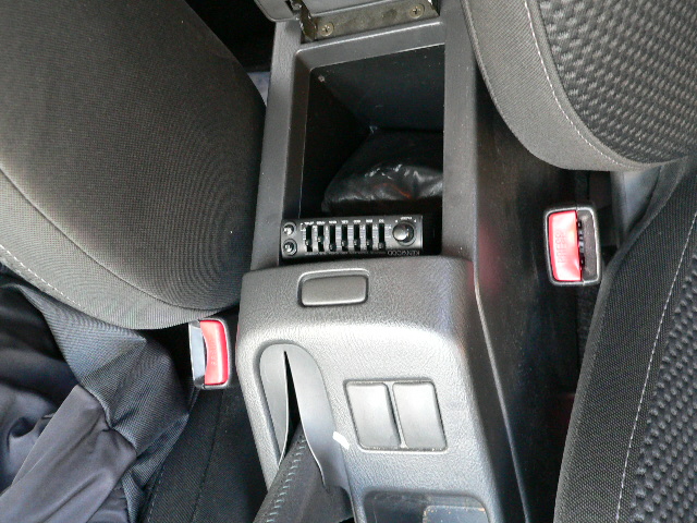

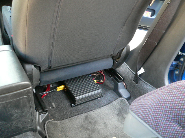

here are the pix. I used the stock sub harness to a LOC then into my pre amp. Then I ran the outputs to 4X100 for the doors and the 150w mono amp off of the eq's sub output. I took the spare tire cover and cut 3/4" MDF to match it. I know the speaker grill looks ghetto but, it's made out of steel and I still carry stuff in my car and I dont have to worry able the speaker getting damaged. The fosgate sub still left space for my spare. Let me know if you got any question. As you see I also added sirius sat. radio. I ran the wires through the dash at the clock pod and I wired it in with the JVC's FM modual. I ran the att. all the way to the back under the headliner. So far I tinted the windows, added 20 mm sedan rear sway, and mud flaps. The back say"You just got beat by a wagon"
