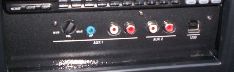

I finaly got around to finishing off the face plate. I love woodland scenics dry transfer letters, just so easy to use, they look great and happy under some clearcoat.
