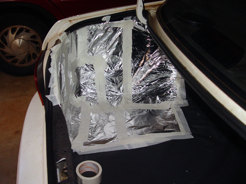

Just to be on the safe side, i put down a layer of aluminum foil (89 cents at walmart!). It wasn't quite as easy to work with as the tape but it worked.

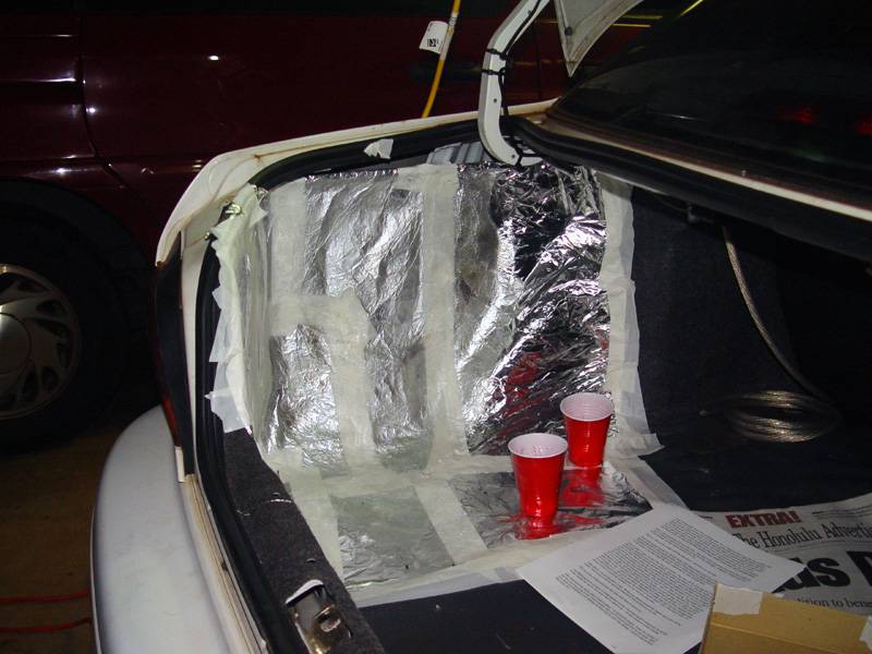

Here's the first layer of glass about 1/3 done. The area that's tinted white in the center is where the fiber cloth is. You'll notice there are two cups sitting there. On a batch of resin/hardener i decided i'd mix a little more. Bad idea. It started to gell up with i was only about 3/4 the way through it, and eventually became unusable. Oops. I learned my lesson to only mix 1 to 1.5 oz out a time.

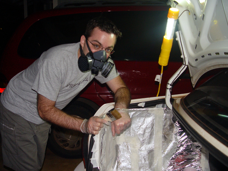

Ok, last picture. Here's me posing next to my trunk proving i at least tried it.
good stuff. i can't wait to see how it turns out. Hey whats that wire running along ur trunk? did u wire a trunk pop? if so how does it work, because i put on in my trunk but i still haven't got all the kinks out.

My car actually came with a trunk pop (handle by the driver's door). I'm not sure if that is the cable used or not. I had planed on turning it into a power trunk pop for use with my alarm but hadn't gotten there yet.
