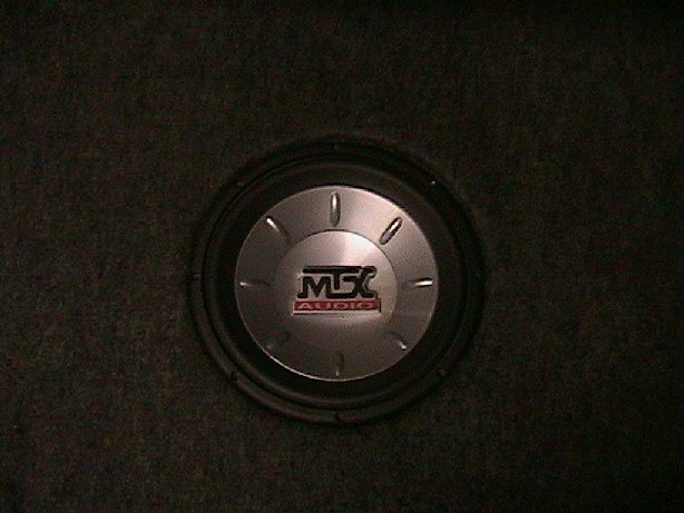

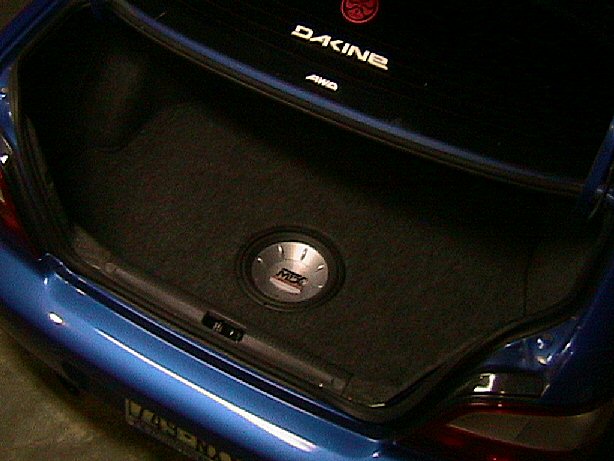

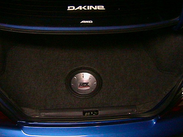

My friend and I finished up an enclosure for my 10" MTX 6000 and Alpine MRV-100M Amplifier the other day. This was the first time my friend or I had worked with fiberglass or tried anything custom. I took out the spare in my sedan because it is tiny and I have my stockers sittin in my garage in case of a flat. I molded a fiberglass enclosure into the middle of the spare tire well, cut up a 3/8" piece of plywood to fit the contours of the trunk, used a 3/4" strong piece of plywood to mount the sub onto, mounted that piece of wood to the 3/8" plywood, bonded the fiberglass tub to the plywood, mounted the amp onto the underside of the plywood on the right side of the sub, and used a 3/4" strong and glued the carpet to the plywood. That all probably sounded really confusing... All and all turned out hella nice for what I thought it would. The sub is flush with the floor. The carpet looks a lot better know that it doesn't move around the whole trunk with anything in it! Here are some pics...
