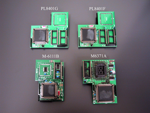

That ECU you have looks interesting, If you come to the Dyno Day, remind me about it, I would like to hear about it.
JUN makes some good product.

Thanks for checking out my ECU.
