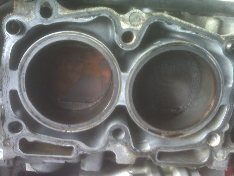

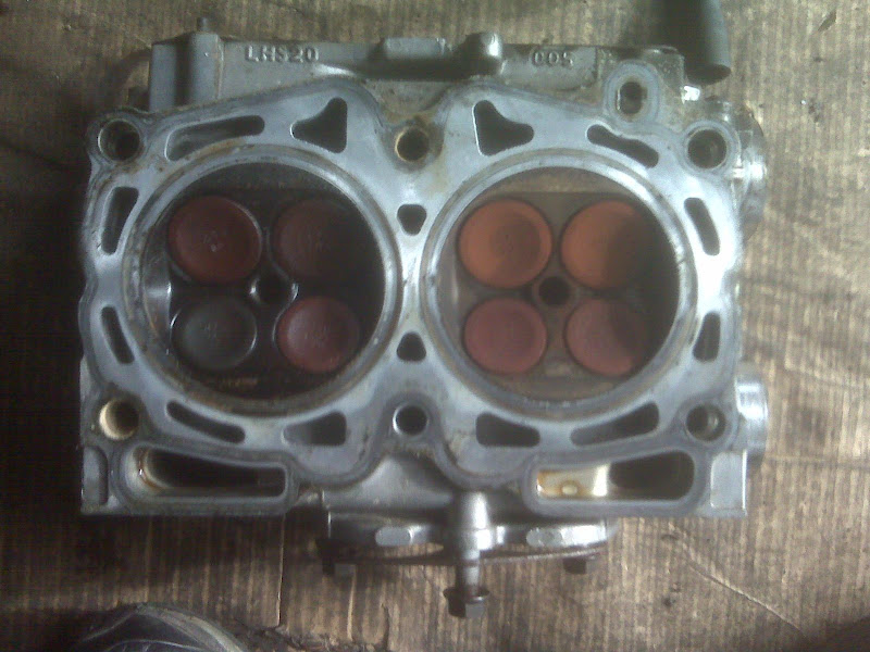

So After 148,000 miles of pure bliss since 2002, on January 28, 2010 my motor decided to run crappy. Took it to LIC and they determined cylinder 4 mis-fire and could be possible valves. Low compression and 3 and 4 also. 1-2 were good.
After about a week of contemplating what to do, I am unemployed and pretty broke. I decide to pull the motor and see what I could do myself. I pulled the heads and saw there was oil in cylinder 4 and sent the heads off to be cleaned and inspected. 3 days later he told me that cylinder 4, 2 of the valve ports had crack in them by the spark plug. So instead of sourcing and rebuilding my 2.0 L EJ20 I decide to source a JDM motor. I came up on a JDM Spec C motor with ecu and all accessories for a really good deal. So now I am continuing my bugeye's life with a fresh motor with more power and fun! hopefully I have another 8 years and 150,000 miles of bliss.
Pulling the Blown Motor
Bad Head
Dead Cylinder 4, oil in it no bueno!!!
