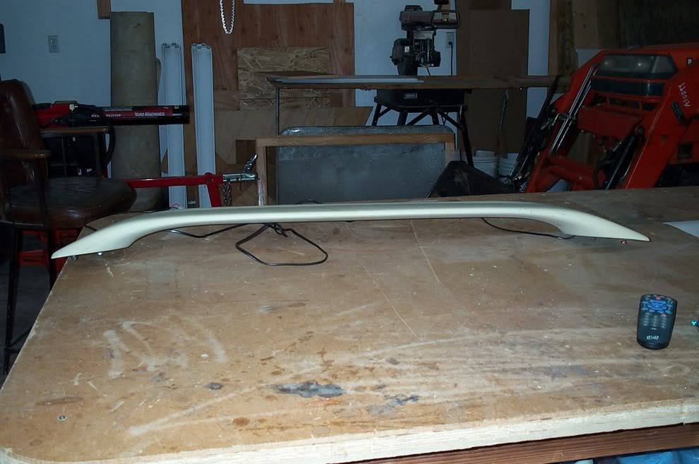

i installed a legacy wing onto my wingless L. really easy. even my dumb *** did it. what i did was use a really wide peice of wax paper and put holes in the wax paper where the bolts are for the spoiler. remember, you have to get a cable through the trunk as well for the light. once you find out where you want to put the holes, tape down your wax paper with masking tape so it doesnt hurt the paint or leave a residue. i also advise putting down tape where you are drilling right on the paint so it doesnt curl out and stuff. then, you drill. i had to do some dremeling of the underside of the trunk to be able to fit the nuts onto the bolts. to seal the wing so water and **** doesnt get in i cut up peices of an innertube and used some silicone crap. all pretty basic stuff.
heres pics
stock car:
bare fiberglass wing:
wing again:
finished product:
