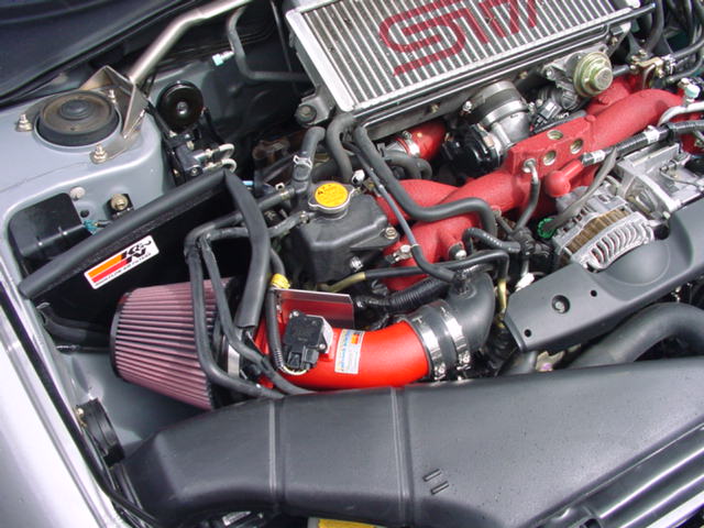

I just put on a K & N Short Ram intake
I just installed my intake and I am pretty happy with it. Doesnt do much for horsepower but it looks and sounds great. I notice a little more pep in my step though. I have exhaust and downpipe and access port. It doesnt mess with the engine at all. I did a lot of research on the subject and i know a guy who put this brand on his 05 and he said it worked great. So i just said **** it and did it. I am really happy with it. Just to add I do notice that more air into the turbo might be good because i did go from stock exhaust 2" to aftermarket 3". So the air going in is as much as the air going out. It just seems a little smoother to me now. By the way SIPOST you dont have to remove the flat air scoop with a short ram (as seen in the pic) not sure about the CAI.
About what turtle speed said about the hot air issue and hydrolock. There is a heat shield with weather stripping to prevent hot air from getting sucked into the intake. It is not perfect to prevent all hot air but most of it. And it has been raining here in the bay area pretty heavy lately and i have not seen any signs of moisture in the intake area. Seems to be a great setup for me. The hydrolock would be more of an issue with the CAI in the fender well i would think. Just my opinion.
Later!
E
Attached Thumbnails Question about intake specific to Washington area-dsc00062.jpg
