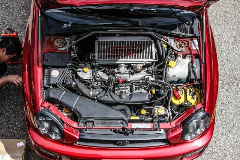

2005 Legacy STish

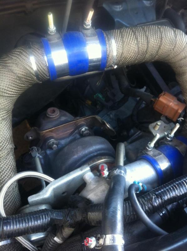

Updated Parts list
EFI Logics Stage 1 EJ257 Shortblock (99.5mm forged pistons, EFI Rods, ARP head studs, killerB oil pickup, nitrided crank, 11mm STI oil pump)
Gates Racing Timing Belt and Waterpump
Blouch 20G-XT turbo with 8cm^2 ceramic coated exhaust housing and braided stainless oil supply line
Cobb Accessport v2 tuner with EFI Logics tune
Cobb SF intake and airbox
Samco 70mm Intake Tube
Samco Turbo Inlet
Samco BOV Hose
Samco Coolant Hose Kit
Samco Radiator Hose Kit
Grimmspeed electronic boost control solenoid
Cobb radiator cooling plate/air duct
Grimmspeed TGV deletes
Grimmspeed Air Oil Separator
RacerX front mount intercooler with DEI titanium wrapped hotside
Forge Bypass Valve
AVO 245lph fuel pump with AVO pump housing
Deatschwerks 740cc injectors
STi GroupN motor Mount
STi GroupN transmission mount
NGK LFR7AIX spark plugs
Tomei Equal Length Header/Uppipe
Cobb Catted Downpipe
Race Ready Electronic Cutout
2011 STi Quad Exhaust
Spec Stage 2+ clutch
OEM 06-07 WRX flywheel
Tranquil TSK3 Tranny Sleeve Kit
STi Strut Tower Bar
Kartboy Shortshifter
Kartboy F/R Shifter Bushings
Kartboy Pitch Stop Mount
Kartboy F/R HD Endlinks
Hotchkis 25mm Front Sway Bar
Hotchkis 22mm Rear Sway Bar
Cobb Reinforcement Brackets
TIC Cross Member Bushings
TIC Pivot Bushings
Whiteline Steering Rack Bushings
Whiteline Front Control Arm Bushings Offset
AVO Front Control Arm Bushing
Bilstein HD Struts
Swift Wagon Springs
Stoptech F/R Brake Pads
Goodridge SS Brake Lines F/R
Grimmspeed BMC Brace
ATE Superblue brake fluid
DBA T2 Font Rotors
Blacked Out Headlights
Volt 4300k xenon headlights
STi 5mt Shift ****
18x8 +35 BBS CK
Conti DW 225/40/18

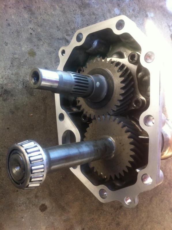

Well this is my write up for swaping all the bearing inside the transfer case. I am not really considering this a DIY because its not as detailed as it should be but it has a good base to work from if your already mechanically inclined. I am not a trained mechanic but I love getting my hands dirty whenever I get the chance so myself and others can learn from it.
I am a garage guy at heart but every opportunity I have the chance to not work on the car with 3ft of clearence I take it lol. A close friend of mine co-owns a shop nearby and he decided the best way to do this is with a lift and power tools.....I could not say no. Though you can do this with hand tools and a jack with jack stands it would probably add another 2 or 3 hours to an already 3 hour job. To start off I would get everything you would need for the job, OIL and any special tools. I decided to do the oil change so I went to O'Reilly and picked up 5 gallons of Shell Rotella 5W-40 Synthetic for $85 with two free Bosch oil filters, YAY! Also I picked up the Transmission Cocktail Gear Oil I will be using for the swap. 2 Castrol Hypoy C, 1 Pensoil Syncromesh, and 1 Redline Shockproof.

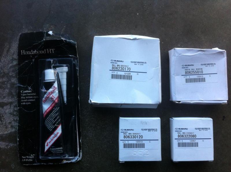

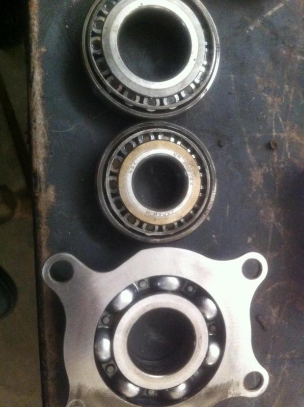

These are the 4 Bearings you will have to purchase from Subaru, I bought everything for $175. You will also need some Hi-Temp Silicone Liquid Gasket and a T70 Bit for the transmission drain plug. When You get everything put the LGT on the lift (or Jackstands)
Ball Bearing 806230170
Radial Ball Bearing 806255010
Roll Bearing 806322080
Roll Bearing 806330120
$175
T70 $5
Liquid Gasket $5

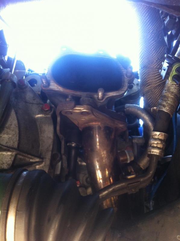

Remove the top mount intercooler and the turbo heat shield from the turbo. There are 5 bolts that hold the downpipe to the turbo and two spring bolts that hold the downpipe to the exhaust, you can unclip the the 02 Sensor plug and leave the sensor on the downpipe. Also remove the the heat shield as well the sits between the downpipe and driveshaft.

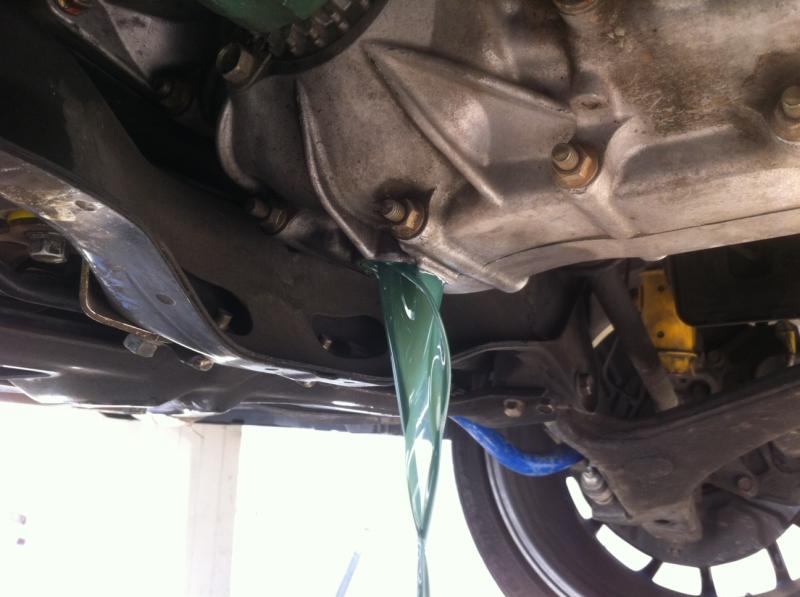

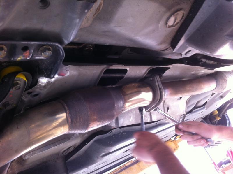

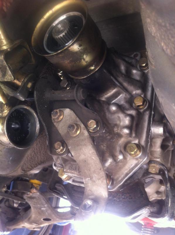

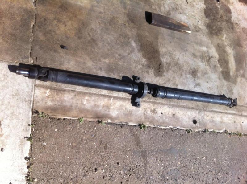

Drain the fluid from the transmission and then disconnect the driveshaft. Make sure you check the plug for any crazy chunks of metal and it clean it if necessary. There are two driveshaft career bolts and 4 bolts that connect the driveshaft to the rear diff. Once all of those are removed you can slide the driveshaft out of the tail snout.

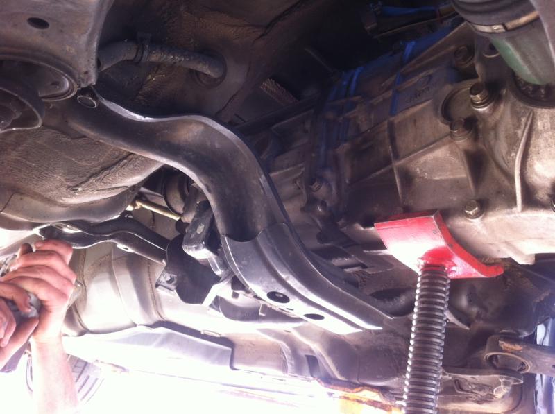

Remove the Transmission Crossmember. There are 6 bolts that hold the crossmember to the car and 2 bolts that hold the crossmember to the transmission. (This would be a good time to install new whiteline crossmember bushings).

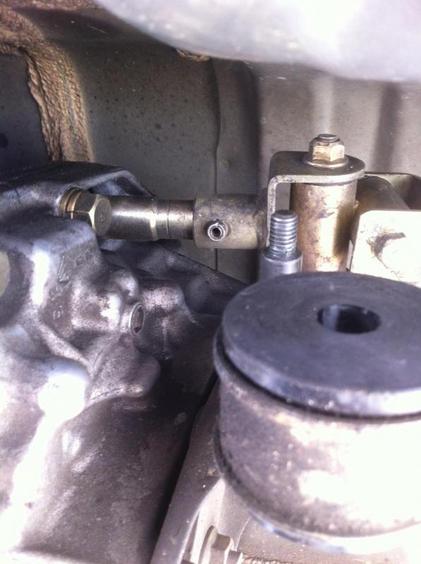

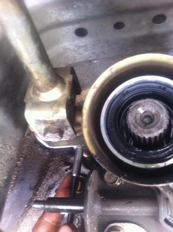

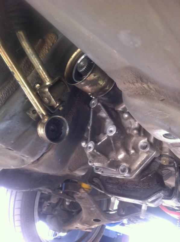

Disconnect the shifter linkage from the transmission and knock the roll pin out with a hammer and punch. (This would be a good time to install some Kartboy Shifter Bushings or if you already have them regrease them).

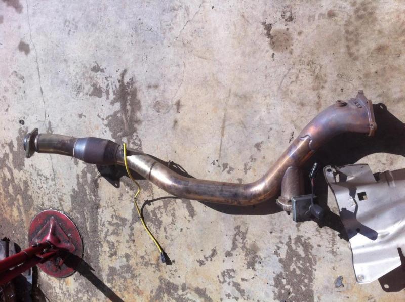

Remove the 3 bolts that hold the downpipe hanger off the tailshaft cover and then remove the 9 bolts that hold the cover itself. Make sure you have a pan ready to capture the remaining transmission oil that will come out.

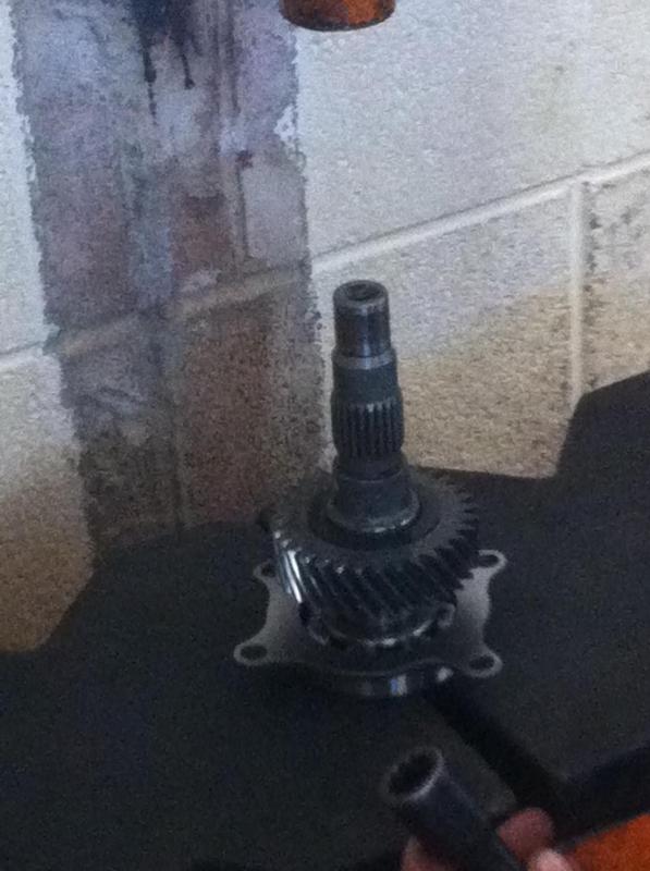

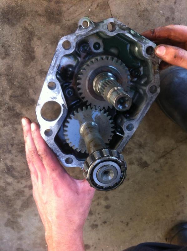

When the cover is removed the transfer drive gear and the transfer driven gear will most likely be attached to the tail cover. The center diff will also slide out with no issues as well. In the transfer case up toward the top there is a ring called a Bearing Race that needs to be removed.

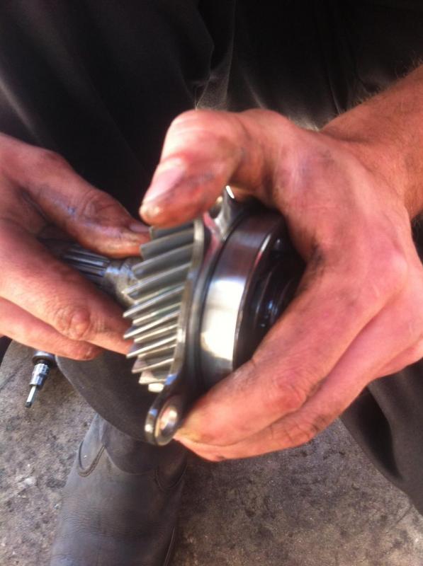

When looking at the Tail Cover the transfer driven gear can be a removed easily and you will have to remove the bearing race from that as well, make sure you pay attention because there is an adjusting washer that sits under the bearing race. The bearing races will be replaced with the new roll bearings but the adjusting washer will not be replaced and will have to be placed back underneath the new bearing race. the transfer drive gear will need the 4 allen head bolts removed before you can remove the shaft. On the transfer drive gear there is a snap ring that sits on the on the cover side of the bearing, this will need to be removed before the bearing can be pressed off.

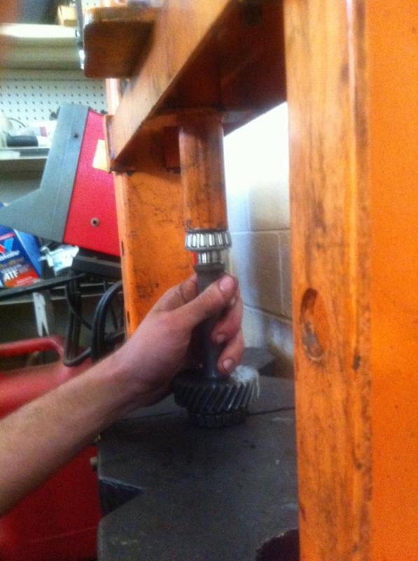

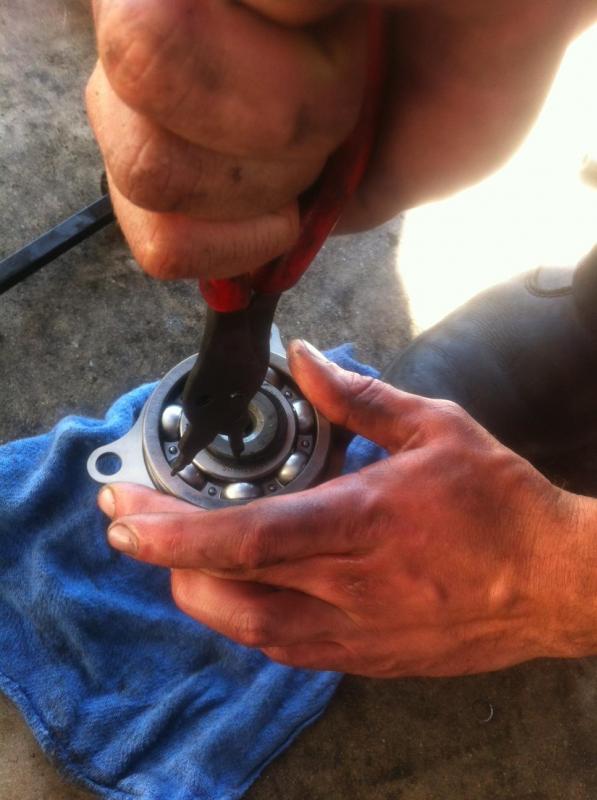

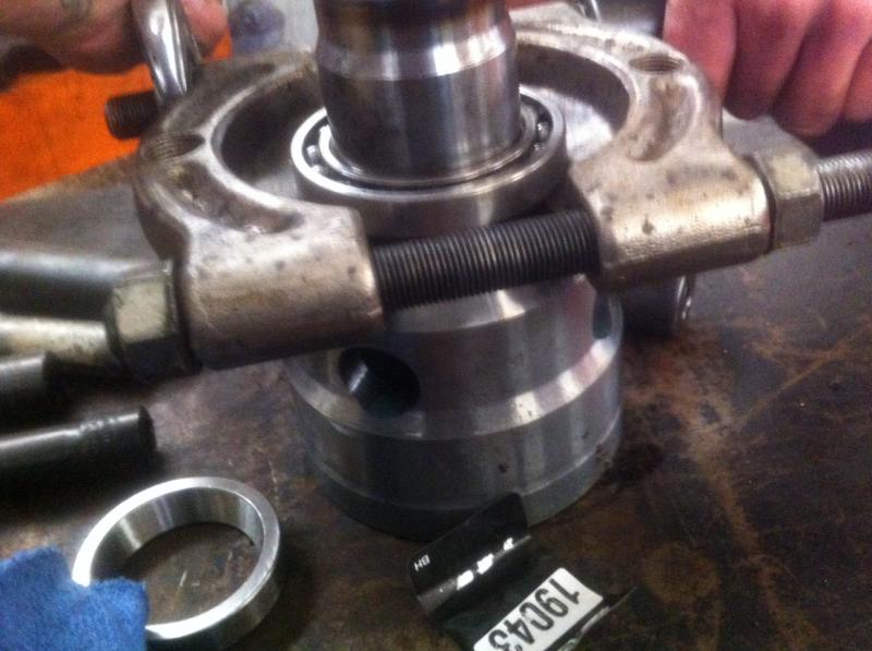

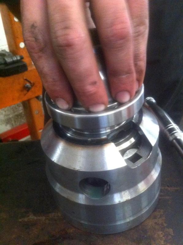

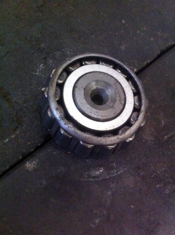

Bearing splitters and a press are key to removing all of the bearings safely. I do not recommend anything else. The 2 Roll Bearings go on the transfer driven gear, the Ball Bearing that is attached to the cover with allen bolts goes on the transfer drive gear. The Radial Ball Bearing is pressed onto the center differential intself.

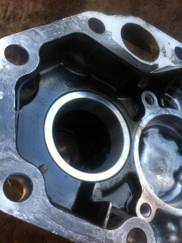

CLEAN EVERYTHING! The diff, transfer gears, and the case/cover. Use scotchbrite where the case will mount. Make sure you install the new bearing race back into the transfer case up in the corner and also in the tail cover with the adjusting washer. Place the center diff back into the transfer case. Install the snap ring back on transfer drive gear and install the gear back on the tail cover using the allen bolts.

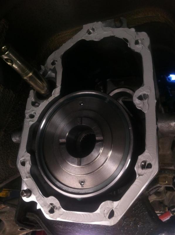

Now use the liquid gasket (HONDABOND LOL) and make sure you install a nice clean bead around the case. Bolt back the 9 bolts to hold the cover to the case and the 3 bolts that hold the downpipe bracket. Punch the roll pin back in and also install the shift linkage back on. Attach the crossmember with the 2 bolts to the tranny and 6 bolts to the car. Slide the driveshaft back onto the snout and bolt on the 2 bolts for the center driveshaft mount and 4 bolts to the rear diff. Install the heat shield and bolt the downpipe back onto the turbo and exhaust. 5 bolts to the turbo and 2 spring bolts to the exhaust. Plug the 02 Sensor back in and make sure everything is tight!
Old May 27, 2013 | 10:47 AM
teriyakibbs's Avatar
Joined: May 2013
Posts: 34
From: SLO, CA
Car Info: 2005 Subaru Legacy 2.5GT
Now for the Transmission Gear Oil. Use all of the Redline, Pensoil, and 1 Castrol. Now use the last Castrol until the transmission is full.
One thing to understand is Subaru updated their bearings over the years so dont get scared when you open the case up and notice that the 2 roll bearings are different. the roll bearing themselves are smaller and the bearing races are bigger but everything is a perfect fit I assure you.
I did this swap because my transmission was getting louder and louder during accel and decel in gear. While cruising it sounded like marbles were loose in the transfer case. NOW DID THIS HELP!? yes a little but the transmission is still a little loud but I hope this will help prevent my 5MT from exploding until I get my 6MT.

I just finished installing a new(used) Tomei Equal Length and Up Pipe, and DBA T2 Rotors. I also sold my Perrin BPV for the new Forge PBV to get ready for some other future installs To add to the suspension I got really good deals on some Whiteline Offset Bushing and AVO Front Control Arm Bushings.
I also Installed the following kits
Samco Turbo Inlet Kit
Samco Intake Tube Kit
Samco Intercooler/BPV Hose Kit
I am waiting for a couple new Coolant Hoses for the reservoir tank and a breather and vacuum hose kit that they just released for the 08+ WRX. My goal with RCM and Samco was to test fit all of these hoses to make sure they work for the 05+ LGT.

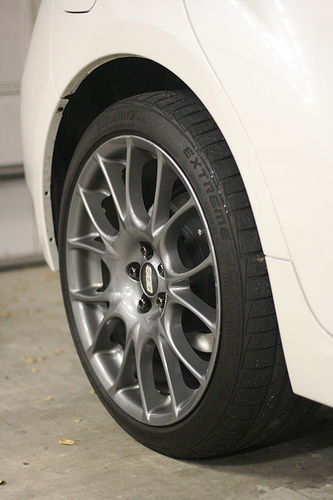

Had a test fit day at my friends house
My BBSs look great on the wide body
He thought he could park handicapped lol
265/35/18
