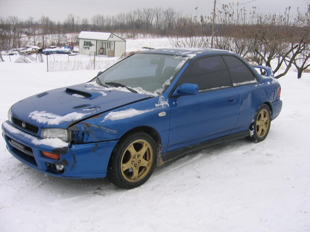

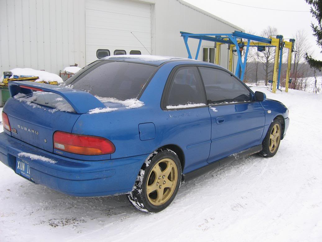

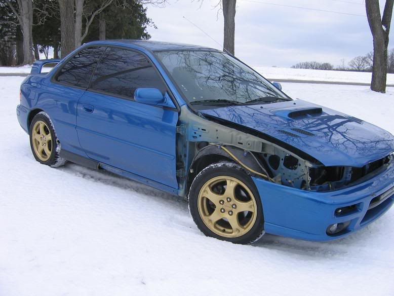

To begin this first post, I will show everything I have done to this point. Here are some pictures of the car just after I picked it up:

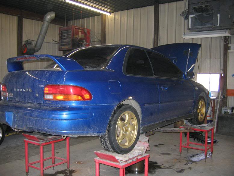

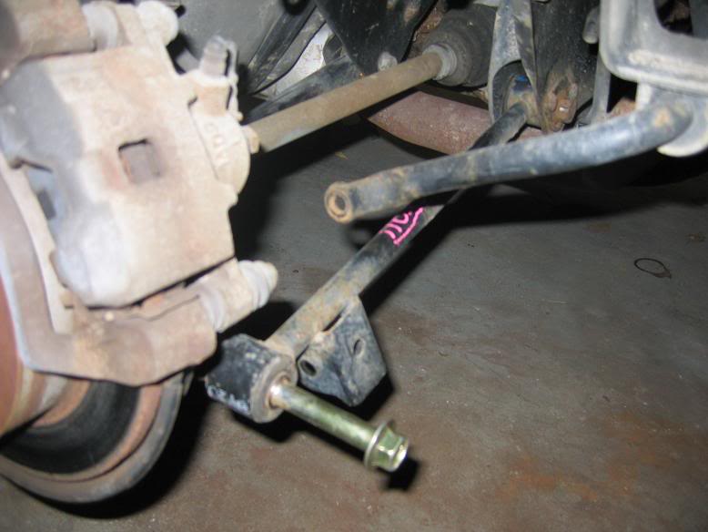

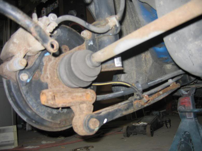

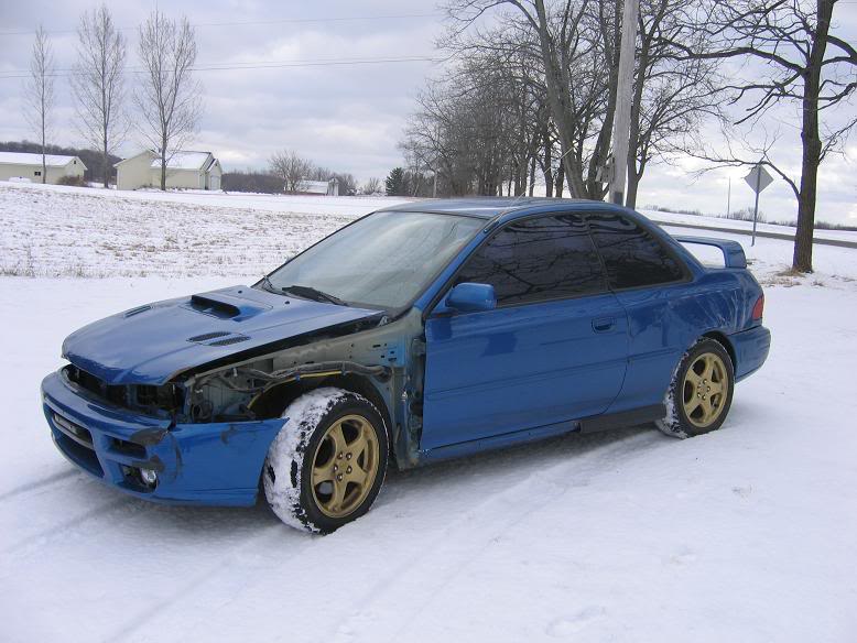

I drove the car home and it went well, however I did notice the car was acting funny. The dealer had told me that the drivers side rear wheel needed an alignment and it was evident from the position of the steering wheel when going strait that the would infact need an alignment. I took the car to the shop I used to work at to get a look at what I had gotten myself into. We put the car up on the lift and discovered that the drivers side rear lateral links were infact bent significantly. Also, the sway bar endlink was broken in two. The front end was unscathed suspension wise, however the radiator support has been moved over towards the passenger side about and inch and a half causing the fenders to sit slightly askew. This would mean that car will have to go onto the frame machine to get the body work to line back up. Some pictures of this...

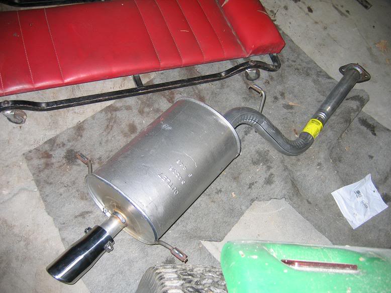

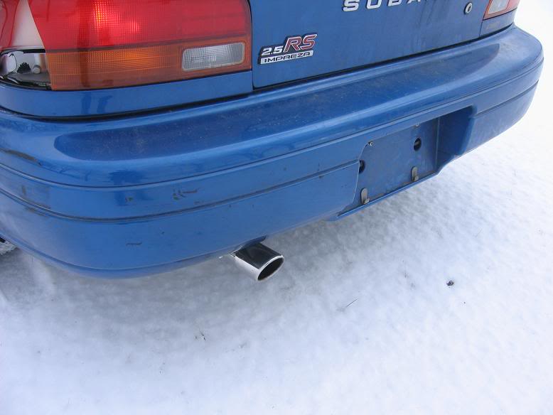

The muffler was rusted to junk so I replaced it with an OE muffler for now. Any mods that will be done will come after the car is road worthy, I decided.
Old muffler v.s. new...

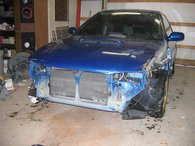

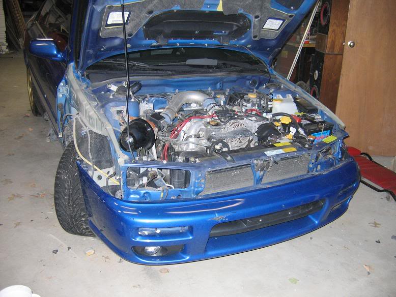

Today I picked the replacement lateral links used for $75 each. Not bad since new OEM parts were around $100 each. Today was also the begining of disassembly on the front body parts to get the car prepared to go on the frame machine. Heres how the progress looks:

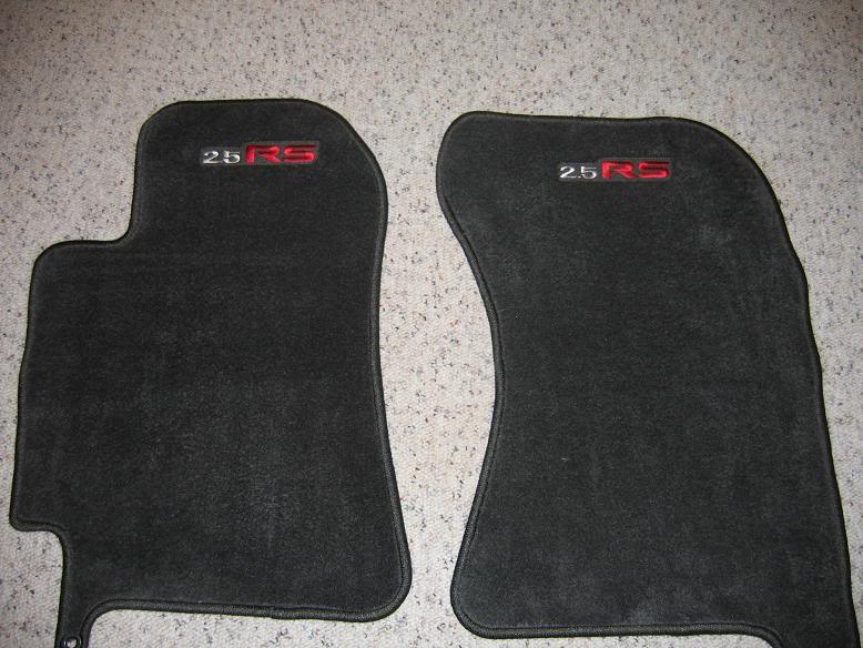

A few days ago I received these as a late christmas gift. Not exactly helping the repairs any, but the are hot...

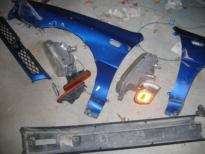

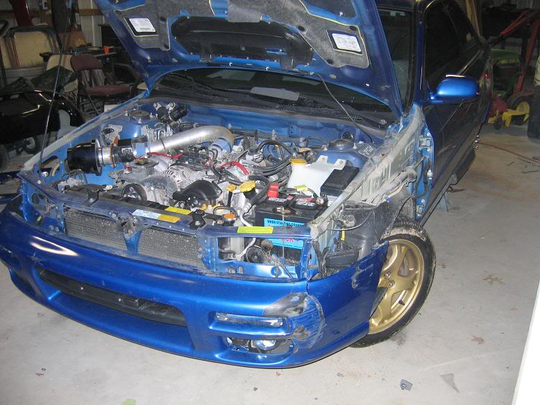

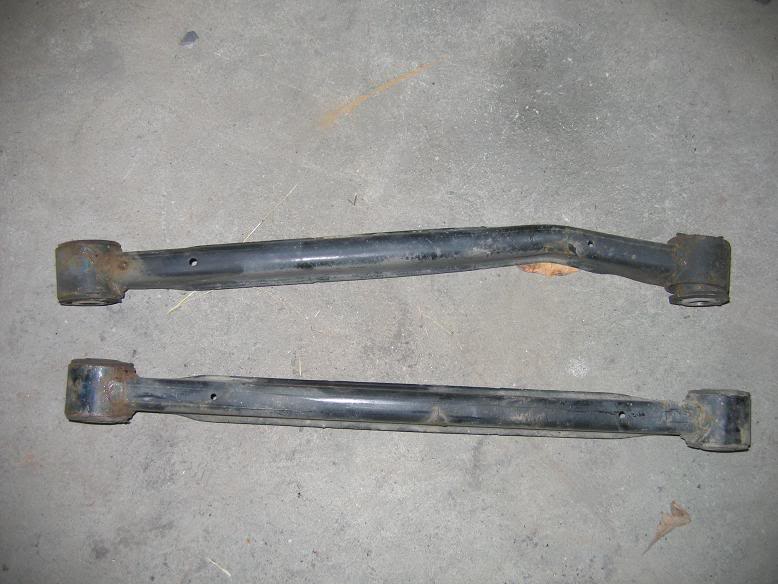

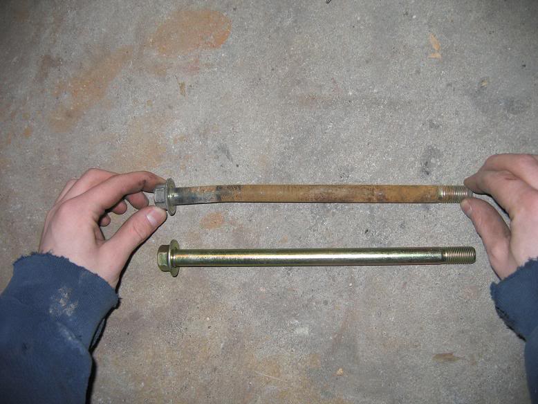

I unbolted the long bolt on the hub and pulled it out about an inch but the bend in it was keeping it bound up. I unbolted the rear lateral link first and then was able to slide the long bolt on the hub out. Heres what It looks like compaired to the new one. Notice the bend towards the head on the old part...

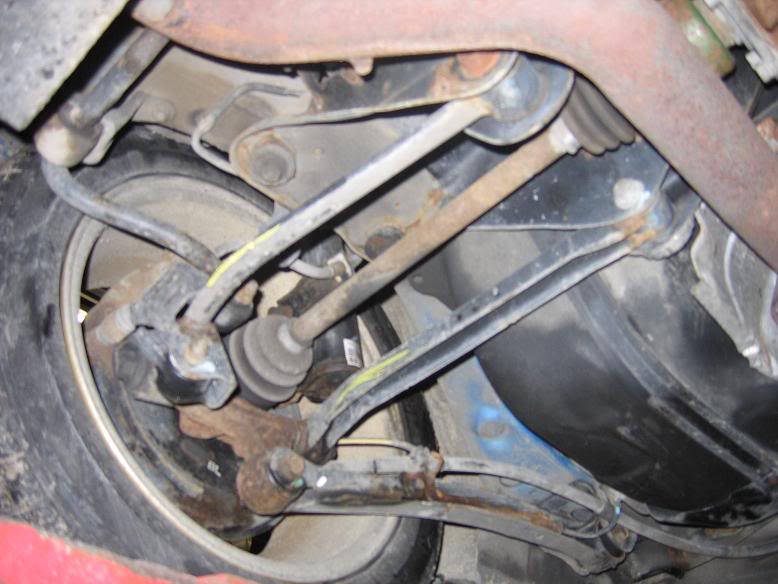

Next I unbolted the front lateral link and pulled it off as well. Here you can see just how bad each link is.

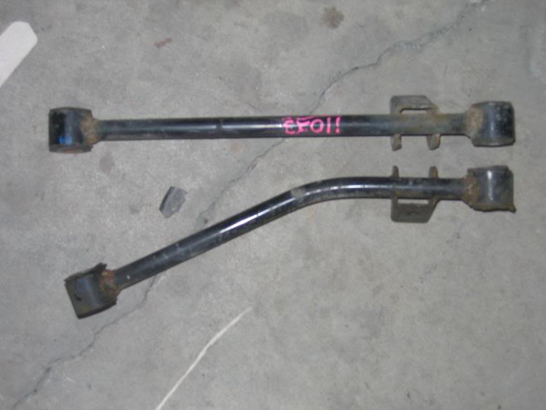

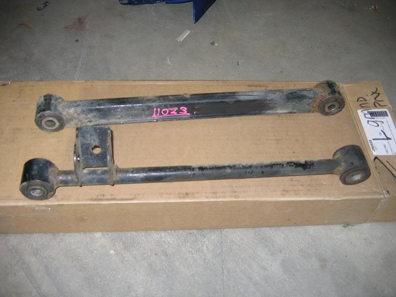

Now this is where things got interesting. I got everything back together as you can see from this picture right here...But see If you notice what is wrong with this....
The shop where I got the parts from (I used to work there, they usualy hook me up with good deals) got me a passenger side rear link instead of a drivers side link! You can see in the comparative picture that the peices are oposites. Oh well, It just means more waiting which Im TIRED of. Blah, Ill update whenever I get it back together.

I finaly got around to bolting up the OE exhaust. I picked up a tip from autozone so it doesnt look too terrible. I also finaly got the correct lateral link and put my suspension back together on the drivers rear (YAY). I took a couple passes up and down the road (good thing the shop im working out of is in the sticks) and the car drove MUCH better. I couldnt believe it, no more bump steer! ha! When I got it back into the shop I took the front bumper off and called it a day. Now I just need to get money together for parts. Being layed of recently wont help that much. :-(
Heres some pics, Enjoy.
