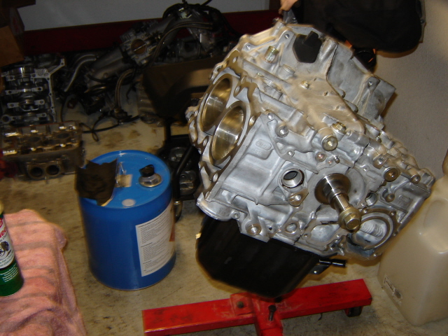

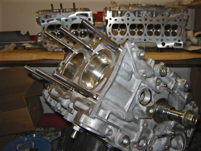

assembled short block....

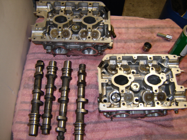

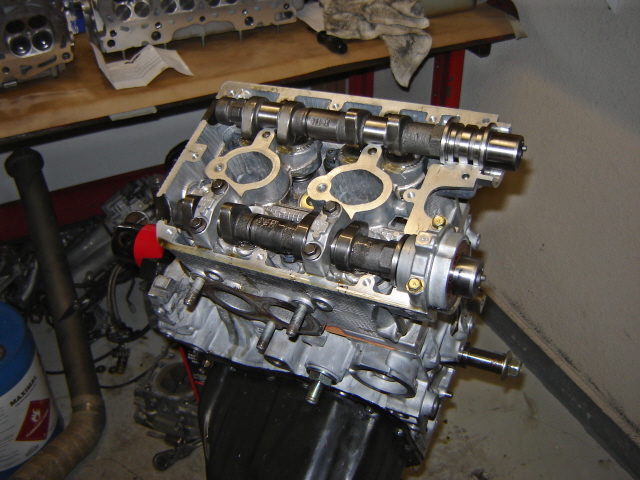

Old Aug 10, 2006 | 12:31 AM
ssautoconcepts1's Avatar
Posts: 124
From: Concord, CA
Car Info: 2002 wrx
cylinder head waiting to be installed...264 cams included. just waiting for the head gasket to be assembled...hopefully this week.

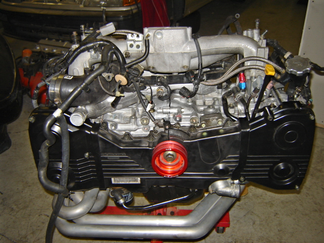

pictures of the engine....
Attached Thumbnails S&S Autoconcepts shop car-post1.jpg   S&S Autoconcepts shop car-post2.jpg   S&S Autoconcepts shop car-post3.jpg

Car is now running. Engine mods are as follows.
- vf34 with sti injectors and walbro fuel pump.
- utec engine management. Stand alone ecu has not arrived yet.
- EJ20 engine with S&S Autoconcepts cylinder head pnp and combustion chamber work. 264 cams, titanium retainers, valve springs. Bottom end has forged piston 8:1 comp and forged connecting rods.
- dynoed at 306 whp. Loss of 6 from the last dyno on stock. This was attributed to a different dyno used the last time. We are very happy with the result of this engine. Power band is very broad. It will run next Wednesday (9/27/06) at Infineon to get quarter mile number.
