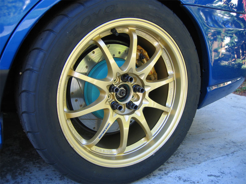

Finally got my CE28N's (Gold)
17x8.5 (44offset)
Toyo RA-1's 255/40/17
Had to cut and roll the rear fenders.
Attached Thumbnails New Shoes and Huge tread for the Beast (Pics)-ce28n1.jpg   New Shoes and Huge tread for the Beast (Pics)-ce28n2.jpg   New Shoes and Huge tread for the Beast (Pics)-ce28n3.jpg

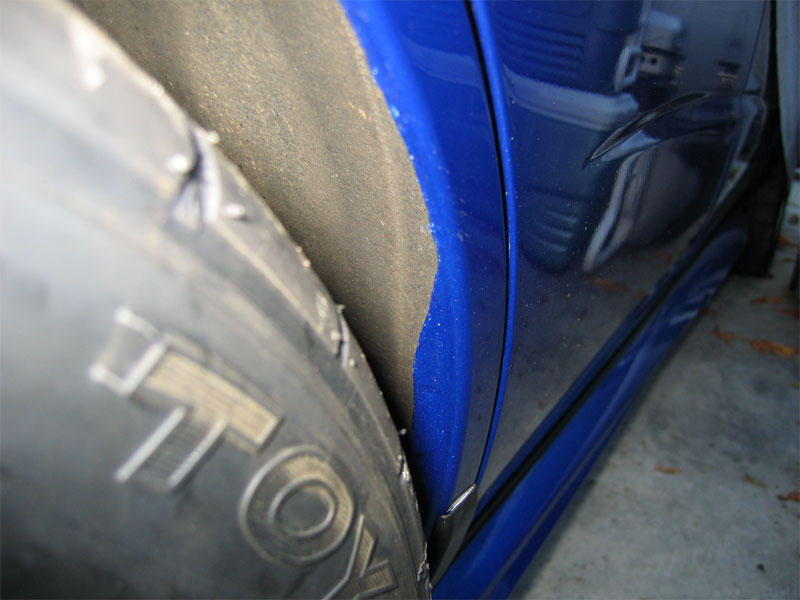

What does cutting and rolling the fenders include?
I mean what do you actually do to the fenders?
Old Sep 19, 2004 | 07:07 PM
wrexr's Avatar
Posts: 1,314
From: Bend, Oregon
Car Info: E28M5, RAM Powerwagon, Motos
I used a cutoff tool to cut/remove the rear fender lip. I purchased some special reinforced thin cutting discs for this job. They were much thinner than the usual discs and cut easily without much heat. Once the excess material had been removed, I used a pipe to roll the edge upward for a clean look. A heat gun helps to prevent chipping of the paint when you do this. A little touch-up paint after to prevent rusting. This is not a mod for the weary. The cut off tool is pneumatic and can cause a lot of damage and injury if not used correctly. I know of a few people who did the same thing with a set of tin snips, I chose a different method.
Here's some pics of the cut area that is only visible from a ground view, as you can see in my first post pics, it is not visible from the side.
Attached Thumbnails New Shoes and Huge tread for the Beast (Pics)-fender1.jpg   New Shoes and Huge tread for the Beast (Pics)-fender2.jpg   New Shoes and Huge tread for the Beast (Pics)-fender3.jpg
