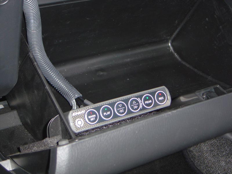

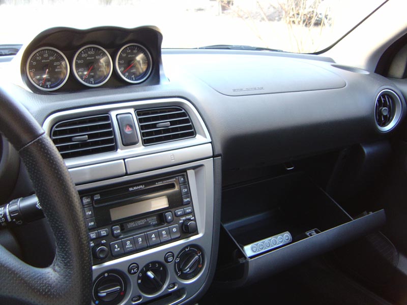

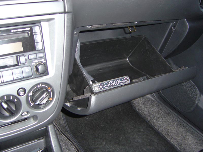

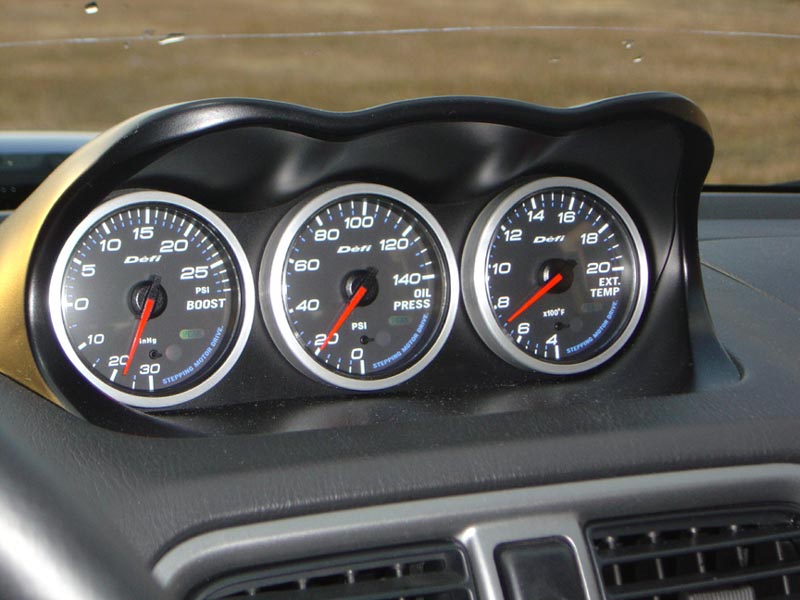

Here are some pics of my Defi Link Gauges with Control Unit. Sorry it took so long to get them up, just had not taken any pictures of them till today.

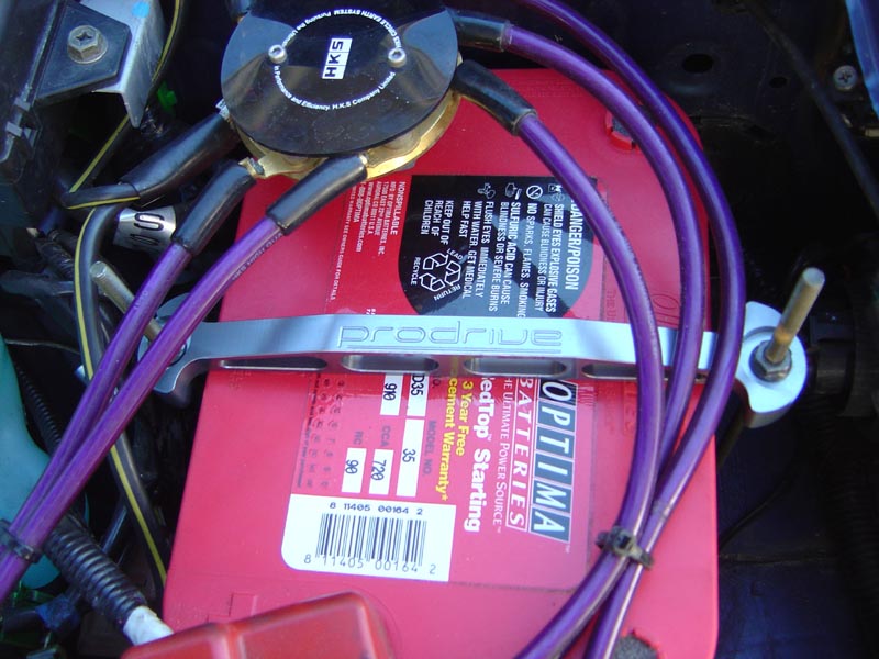

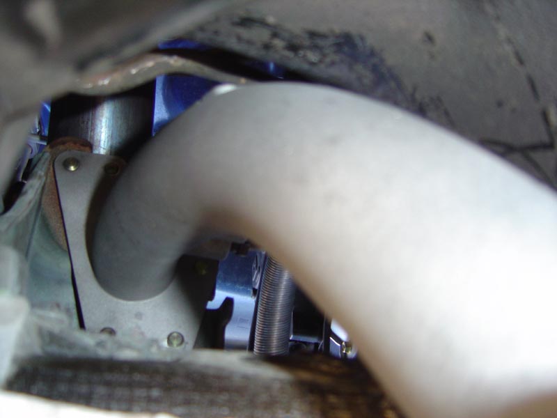

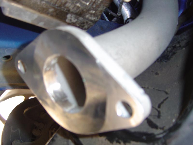

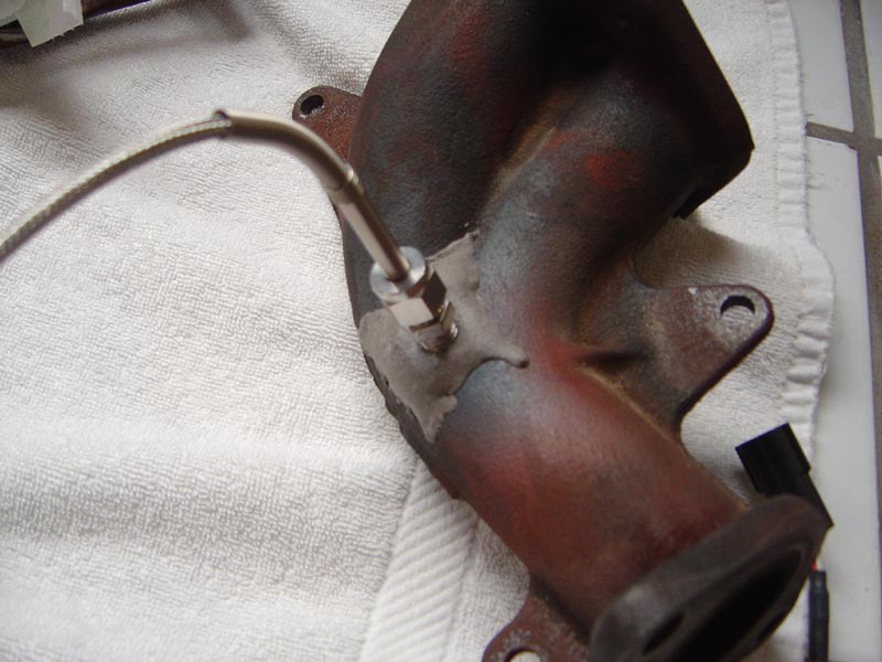

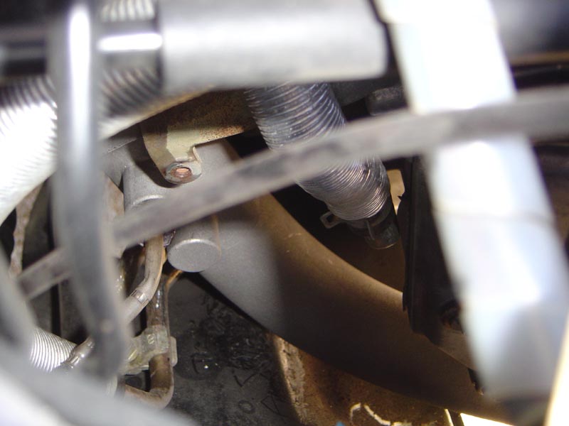

Here are some pictures from when I installed my COBB Up-pipe and installed my EGT gauge sensor. I also throw in a pic of my new Prodrive battery tie down, it gave me lots of power.hahaha...

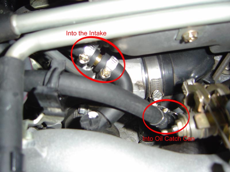

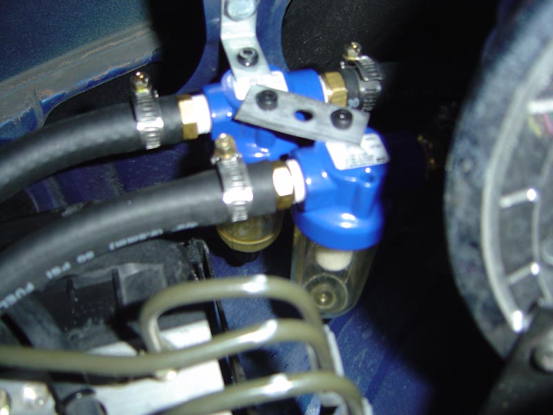

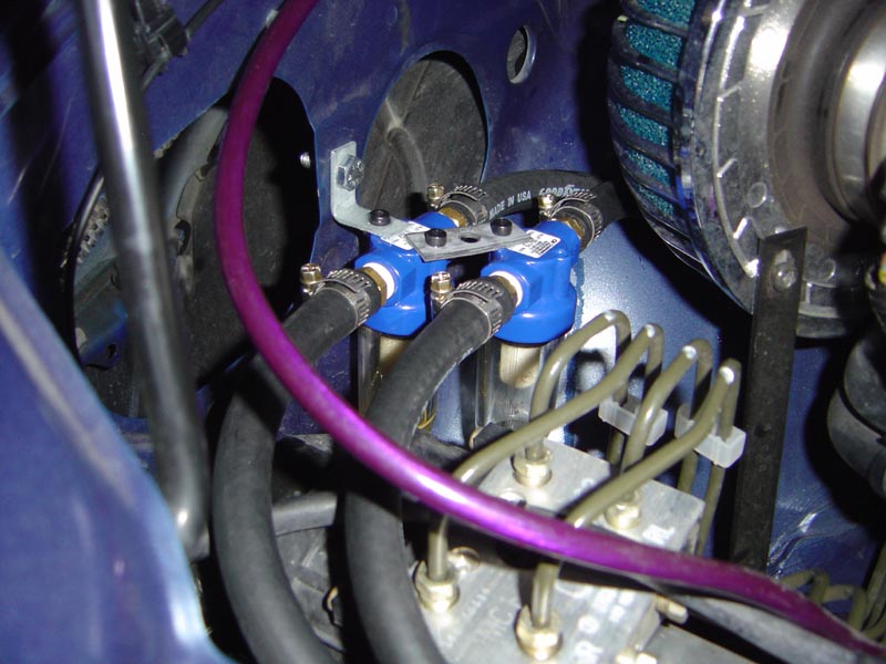

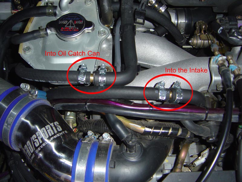

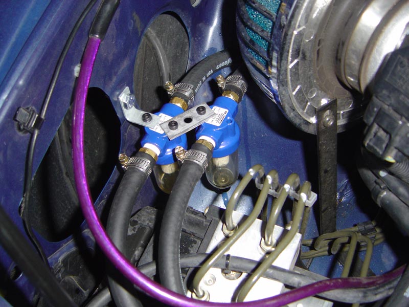

Here are some pictures of my new oil catch cans. I was going to have just one and have both the PCV and crank case go to the catch can and then to the intake but I read that they are under pressure at different times and so they need to be kept separate and they were separated for a reason so really you need two oil catch can's so I figures that sounded about right so I did it. I still have to make a nice cover bracket to clean it up but right now you can see how it all goes together. Here is were I found the install and about the 2 separate catch cans. http://www.scoobymods.com/forums/showthread.php?t=3398
http://www.clubwrx.net/forums/showth...7&page=1&pp=20

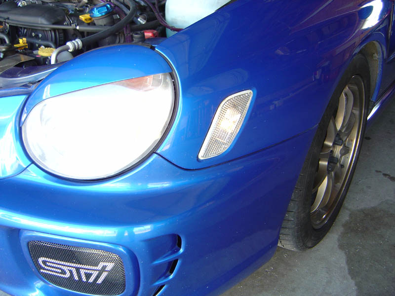

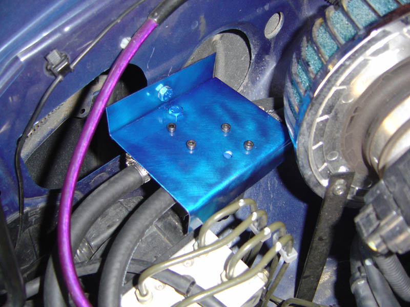

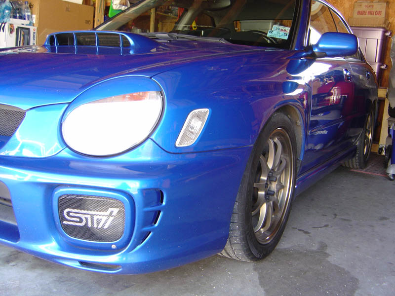

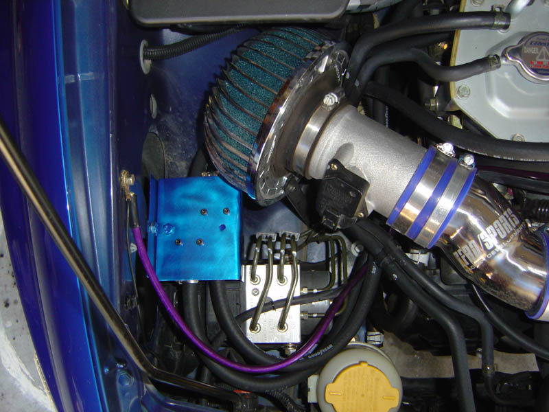

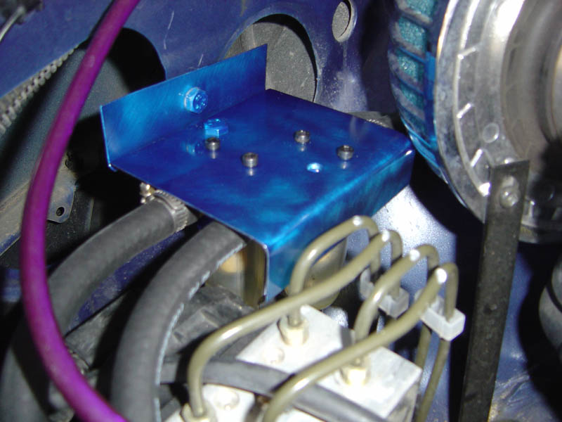

Here are some new pics of my Oil Catch Can Bracket that I made and also some new Clear Side Corner lights I just put on.
