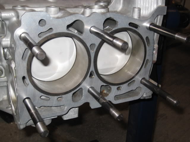

It took me several months to get it squared away (mostly due to my laziness), but the shortblock done now.
- 2.2 Liter Turbo Legacy case, bored/sleeved
- Darton ductile iron sleeves
- US STi forged crank, balanced/polished/drilled for better oiling
- Pauter Forged connecting rods
- Ross forged pistons, moly coated skirts, swaintech gold coated tops
- ACL race series bearings for mains and rods
- ARP oversized head studs
Pictures:

Modifications.
Engine, go fast mods, and misc:
2.2 Turbo legacy shortblock (fully closed deck), bored /sleeved - 2.4 Liter final displacement
Darton Ductile Iron Sleeves
USDM 2.5 STi forged crank, balanced/polished/drilled for better oiling
Pauter Forged Connecting Rods
ROSS Forged pistons, coated skirts, swaintech coated piston tops
ACL Race series main and rod bearings
Oversized ARP head studs
Version 8 JDM STi big port heads
Subaru 12mm Oil Pump from New Zealand

Drilled out my heads for my oversized arp studs, ordered some new arp washers, assembled the heads, needed 10 new buckets (came in today).
Time to get this thing wrapped up!
