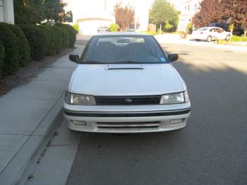

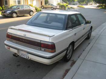

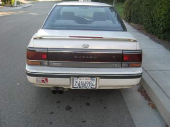

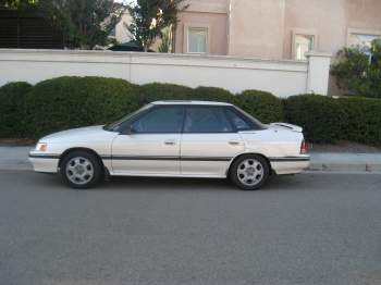

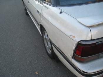

pics. sorry for the delay.
project is on hold due to financial difficulties.
i need to get this rear quarter panel fixed one of these days.....
pics looked ALOT better than seeing this in person
