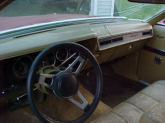

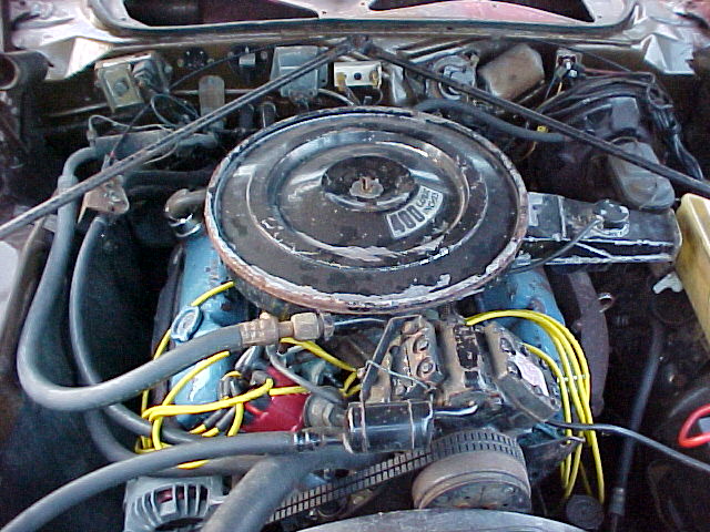

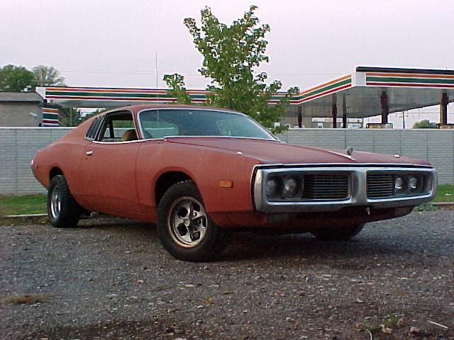

I know I talk about this car alot but it has occured to me yall may have never seen pics of it.
This is a 1973 dodge charger I picked up in a trade for an 85 camero I had.
It came with all the stock componets, 400ci 125hp big block, auto trans, collum shift, and harvest gold intirror...... yeah, im going to change all that
Attached Thumbnails my 73 charger-money-front.jpg   my 73 charger-money-back-shot.jpg   my 73 charger-crappy-dash.jpg   my 73 charger-engine-before.jpg

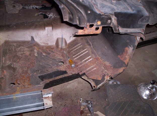

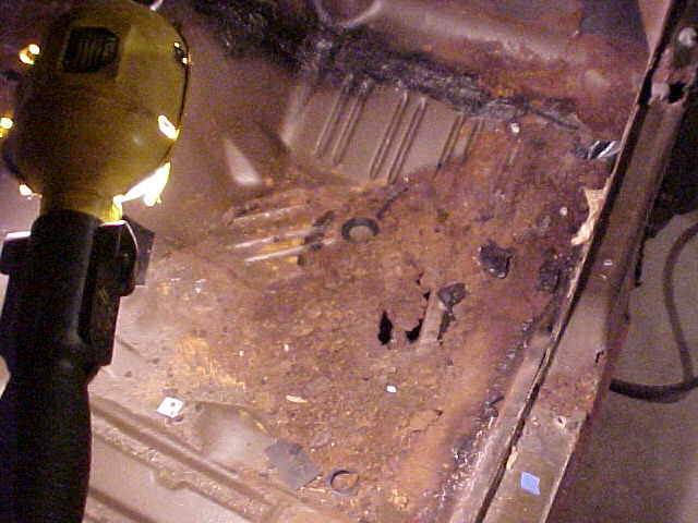

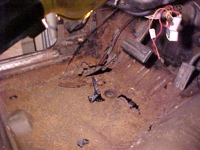

here is what I found when I pulled the car appart.
and yes those are the fraim rails that you see from inside.
Attached Thumbnails my 73 charger-pass-front-floor.jpg   my 73 charger-drivers-front-floor.jpg

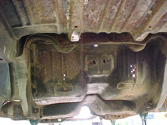

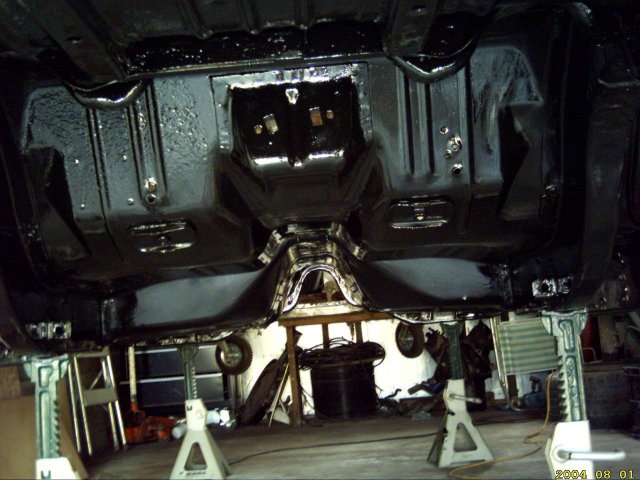

First order of busness was getting something on the under body. I knew this car was going to see alot of garage time and might rot more from the mosture comming off the concreet. so I took the time to break out a wire wheel and grinder to remove all the loose rust and under body coating then I painted it with por-15
Attached Thumbnails my 73 charger-underbodytrunk.jpg   my 73 charger-me-second-coat.jpg   my 73 charger-underbackseat.jpg

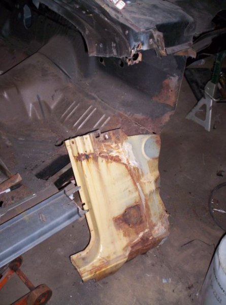

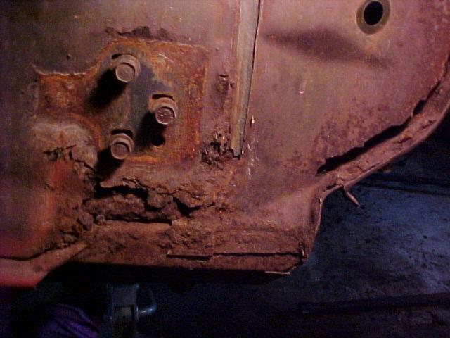

I got some sheet metal sections a while ago and started planning how I was going to cut out the rotted sections of my car and weld these in.... I came to the decision that I would have to go thru lots of work to patch my pannes... so I decided to just go for it and replace the whole section...
so here are pics of the rotted pannel, and after I cut it out.
Attached Thumbnails my 73 charger-panels-i-need.jpg   my 73 charger-hingearea.jpg   my 73 charger-clippy-005.jpg
