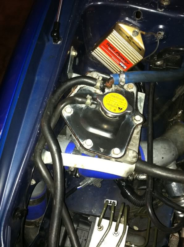

Holy messy wiring, batman.

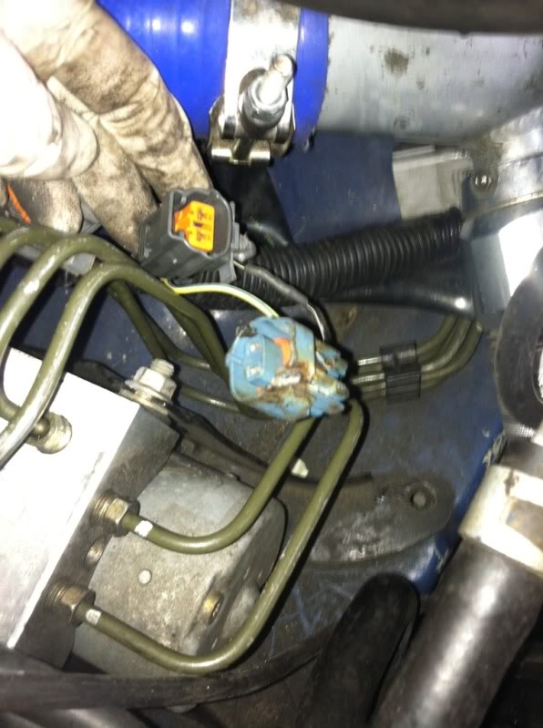

The following pictures are what I found when I went digging tonight. I ran out of zip ties and electrical tape, so I don't have any after pictures.
And here's what it looked like when I called it quits tonight. Not perfect, but significantly better than before. I've definitely got my work cut out for me.

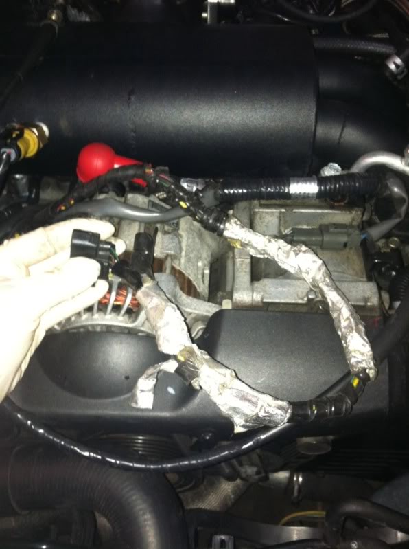

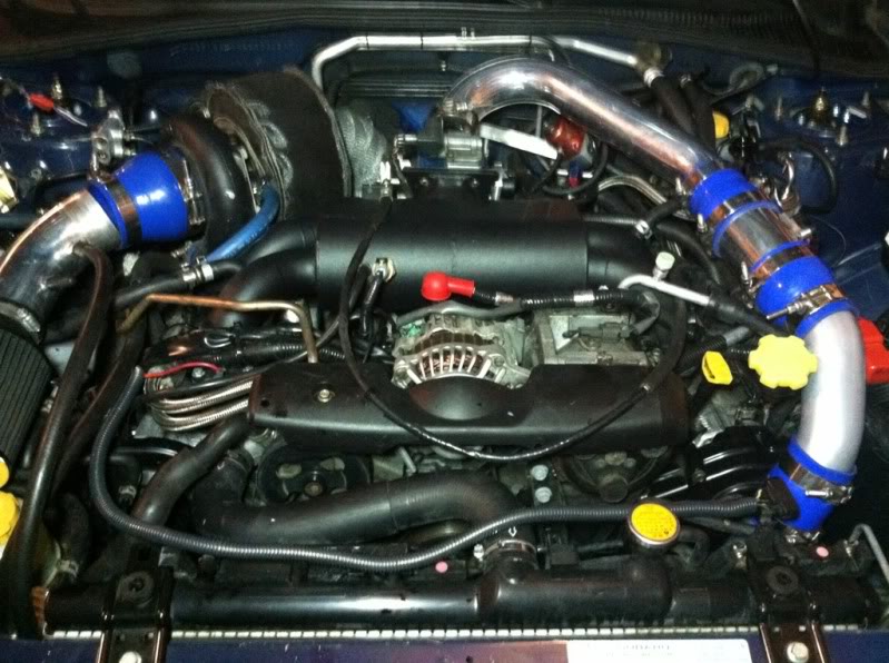

Chunk of wiring harness from the first picture of the last post now looks like this. Only a few areas left to clean up. Should be done tomorrow. Yay.

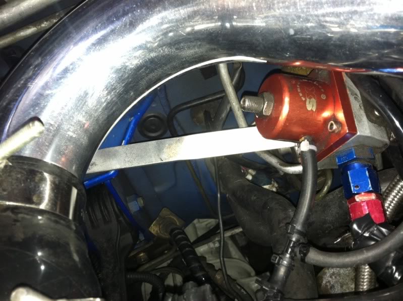

Any suggestions for making brackets that aren't ghettofabulous? I can wire, I can diagnose, I can fix things, but I can't fabricate to save my life.

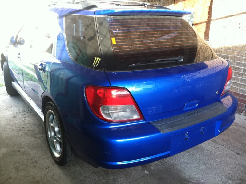

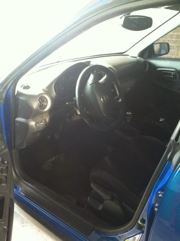

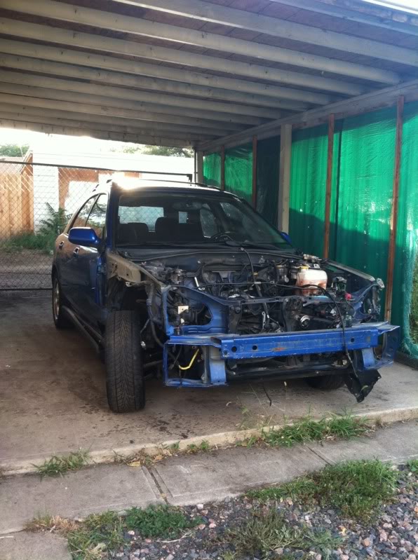

Picked up a friend for my car today. Spent the evening swapping over little parts that my car needed. Glovebox latch, dash trim, center console lid, etc. Tomorrow or Wednesday, I'll do the roof spoiler (mine is cracked), some trim pieces, try to make the washer tank fit, keyless entry control unit (it's not working for some reason), and whatever else I think of as I go along.
Also got the engine harness, so I think I'm going to make a new one for my car since mine is kinda hacked up. It's coming along!

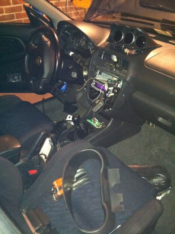

My evening:

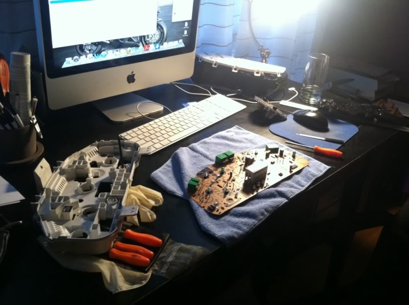

Knock light is removed. I figured out that the little button thing that's soldered into the cluster circuit board has failed. Trying to figure out what my options are now, as I'm not sure I trust my soldering skills enough to try to replace it. Not to mention finding one...
Still no clue what's up with my keyless entry. There's a ton of crazy wiring under the dash and behind the stereo. I'm exhausted just thinking about it. Wiring diagrams are burning me out already. I've been on a roll for the last month, but I'm getting tiiiiired.
