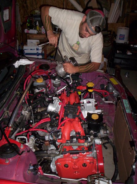

first picture is of my friends solution to the hood prop being in the way and hitting his head on the hood. We think that the hole in the hood and the eye loop on the strut tower brace are made for this.
next one is me a little stur crazy from workin on the car in 90 degree weather.

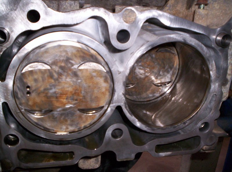

next one is of what i found when i pulled the head off .. I was amazed, over 100,000 miles and still hone marks in the cylinders and no crown ridges.

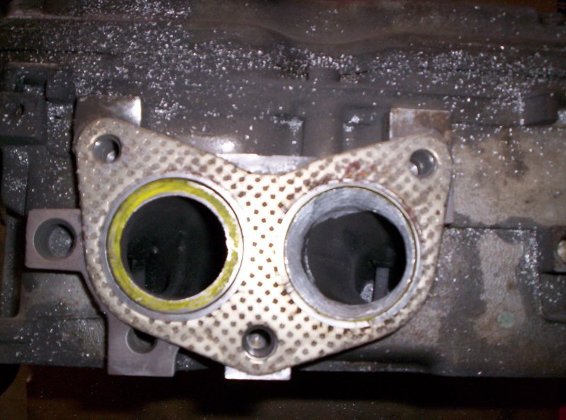

Ok intake is done, one head is done fresh paint on the block (sliver). I need to paint the intake, finish cleaning and porting the second head and I can start reasembling. The first pic is of the exhaust ports. the port on the left is marked with a yellow grease pencil and the port on the right side is after the rough cut.. thats a good 1/2 inch off of the diamiter. the next pic is the cylinders after i cleaned em up, the discoloration is from heat and i did not want to put too much pressure on the pistons while wirebrushing. I am very happy with the progress!

well the engine is back in, intake is on and hooked up. I just need to throw on the ac pump and the alternator and radiator, also some more wireing is in order than i can pressure check the thing after adding fluids that is. Hopefully it runs as good as it looks.. And im loving how it all turned out so far.
well all will be revealed tomarrow.. hope this was helpfull for some.
