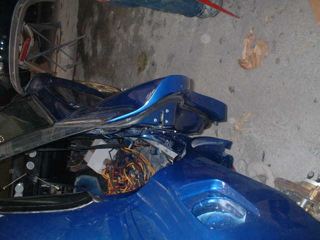

Details on the actual car.
22b Wide body kit, custom blue painted
Sti 6 points 5 passenger rollcage
Sunroof
Sti Ver 6 Seats
Custom leather interior
sti Ver6 Momo Steering wheel
Sti pedals
Sti shift ****
sti short Shift with linkage
Greddy gauges
Sti center gauge pod
Custom Knock link
Sti 10rpms and 280 Km/H cluster
Sti water spray switches
Hella F1100 HID driving lights
Catz Hid dual beam HID
Rear Sti clear lamps
STi clear corners and side markers
Sti front Forged Control arms
Sti rear lateral and trailing arm kit
Sti bushing
Rear 160 Diff with Quaffie ATB
Center 20Kg Sti diff
Front Quaffie ATB
WRX axles
Rear Tarox 13 Inches vented discs with calipers
Front Prodrive brakes
4 corners brake steel lines
Push type cable clutch
ACT clutch with 4 puc disc
Sam Shalack gear box with custom girdle
Invidia 3 inhces exhaust with custom center section to fit the vishnu 3 inches downpipe
Pivot Wide band dattalloger
Hks GT wastegate 60 mm
Turbo Header
OEM wrx oil/water heat exchanger
Graham Goode Oil cooler kit
Sard racing radiator
Sti fans and cowlings
Custom water spray and overflow tank
HKs intercooler kit
Tial Blow off valve
STi wagon dual motor windshield water tank
Aquamist water injection system 2c
Custom fuel system:
2 vishnu high flow fuel rails with 8 AN lines
1 Extra injectors fuel rail
4 primary wrx 440cc injectors
4 greddys 720CC secondary injectors
Canton High flow fuel filter
Anti surge tank custom made
GTR Fuel pump in the tank
2 parallel walbro 255 fuel pump
Inline fuel filters
Have to go I will finish details later
Thanks
DJ
