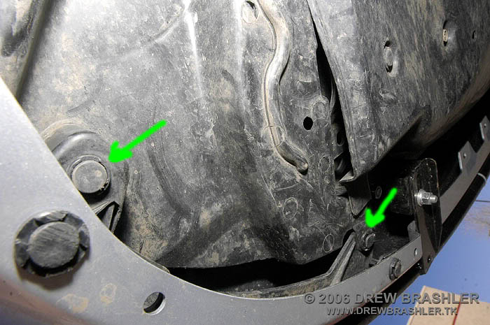

Step 4 – Removal of the Fender Liner Front Part
There are two clips underneath the bumper, pop out those two clips. Then gently pull the Fender Liner down as shown in the photo.

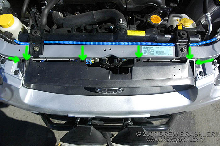

Step 6 – Removal of the Grill and Headlight
Get out your flathead screw driver and remove the grill. You remove it by pressing the tabs where the green arrows point to.

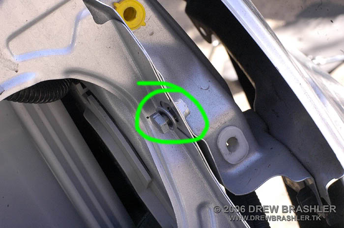

Grab your 10mm wrench and take out this bolt behind the bumper. You can access it through the opening where the grill was.

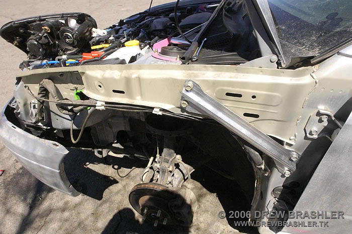

Step 9 - Removal of the Fender
Make sure you take your time with this next step. You can royaly mess up your door paint or bend your fender if you do this carelessly.
Anyway carefully remove the fender. I pulled out the rear part and then removed it toward the rear of the car. You will see what I mean when you do this.

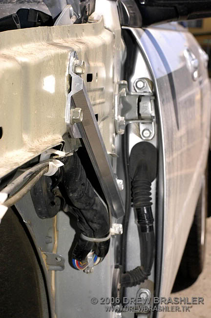

Step 10 - Removal of the OEM Fender Brace
Now you can see the OEM Fender Brace, and this install is SIMPLE!

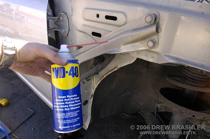

Step 11 – WD-40 Time
Bust out the WD-40 and spray all 4 bolts.

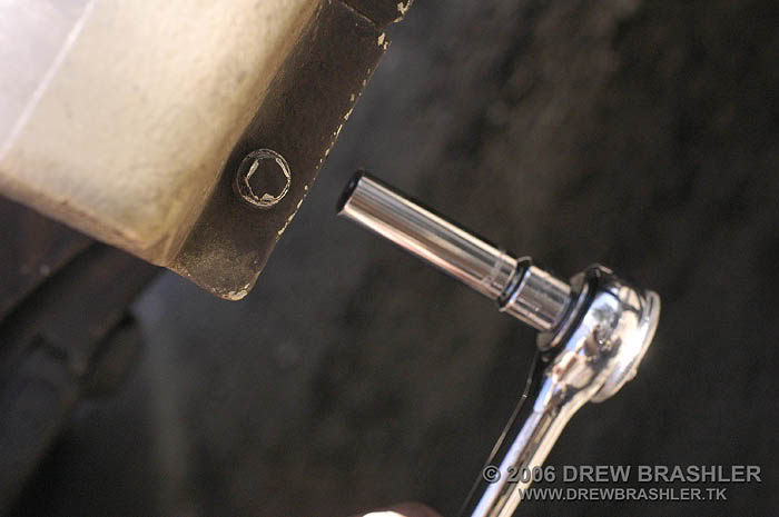

Step 12 – Removal of the OEM Fender Brace
Use a 14mm socket to break these bolts loose. They are pretty darn tight, so take your time. After you get the bolts off the fender brace should fall to the ground. Please place this in its new resting place… the trash.

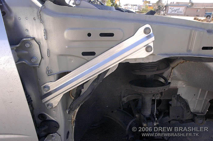

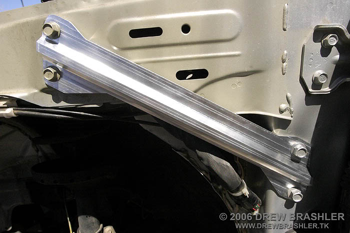

Step 13 – Install of the New Fender Brace
Line up the holes on the new Fender Brace and hand tighten the bolts. Next use your 14mm socket to tighten them down.

Here are more photos of the brace:
