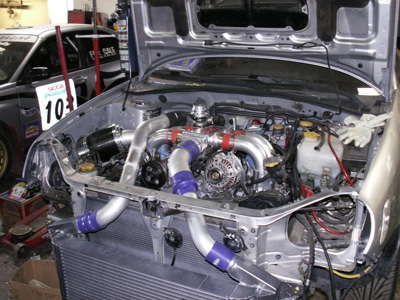

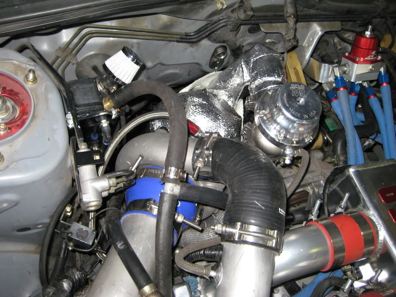

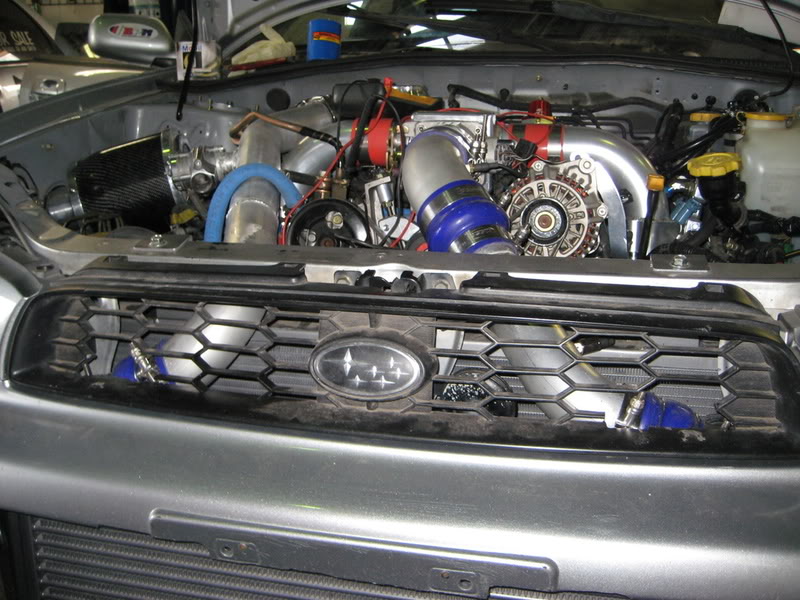

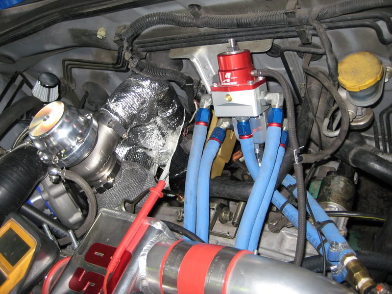

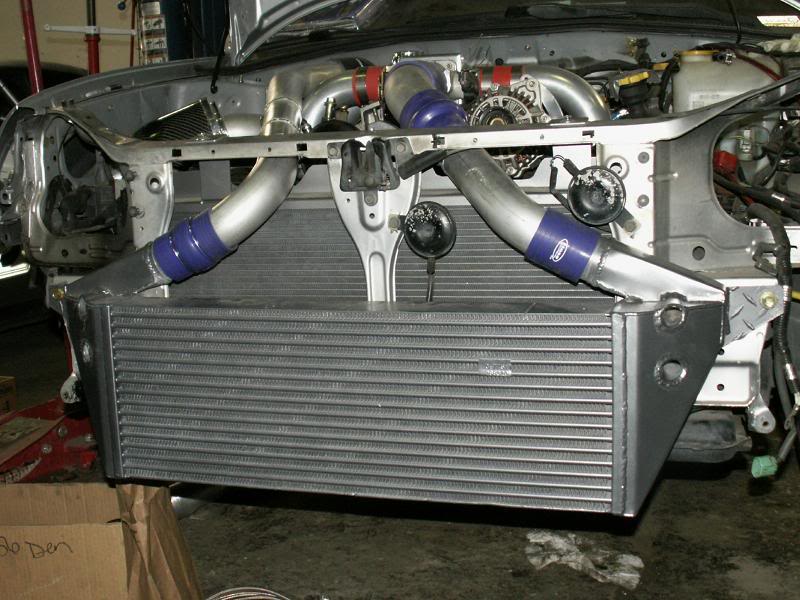

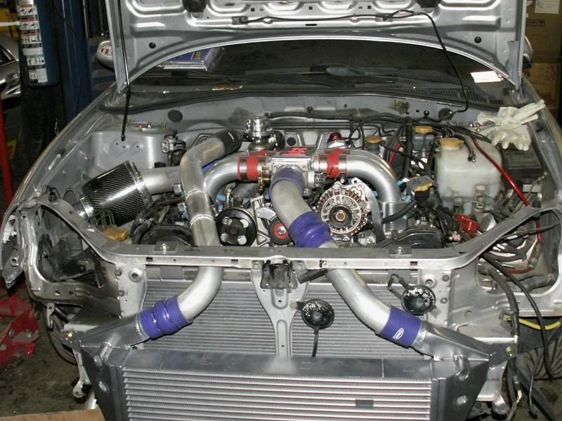

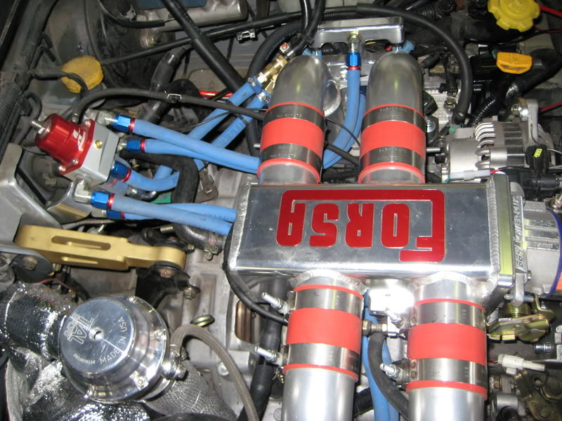

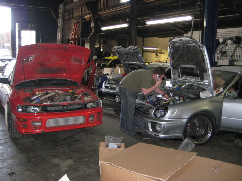

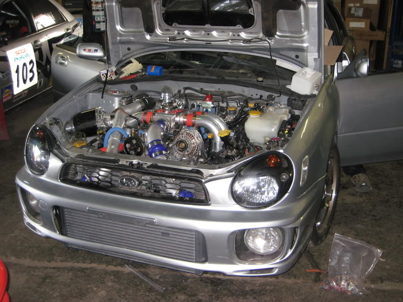

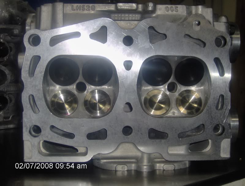

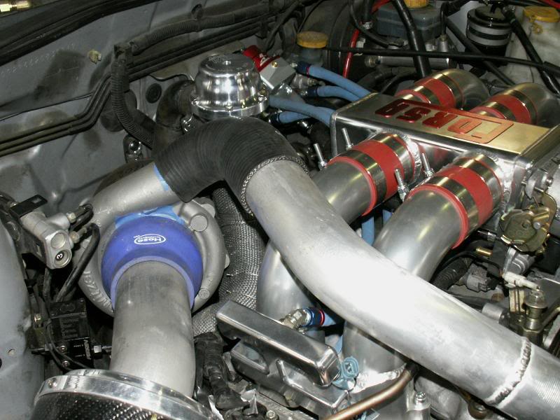

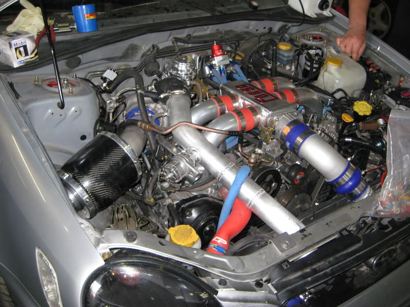

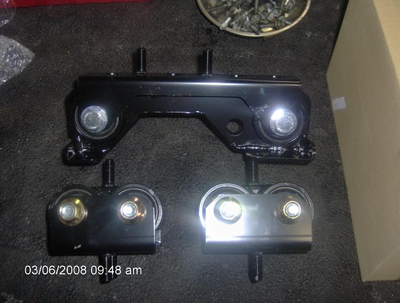

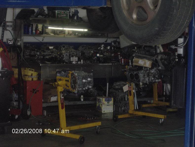

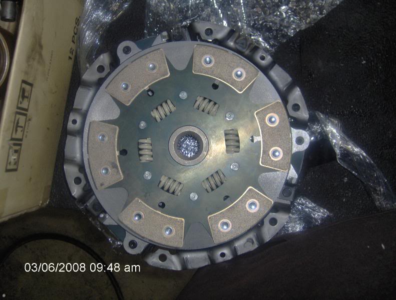

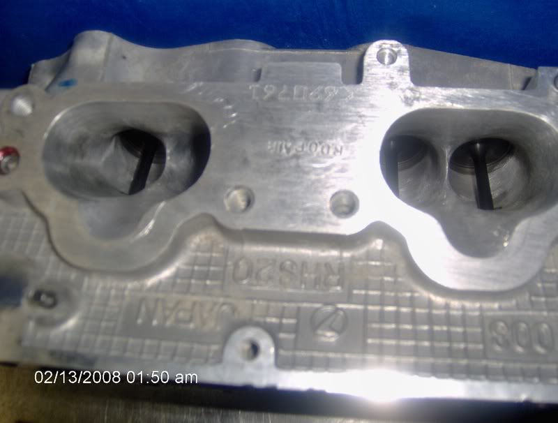

We have been working on this build for quite some time....

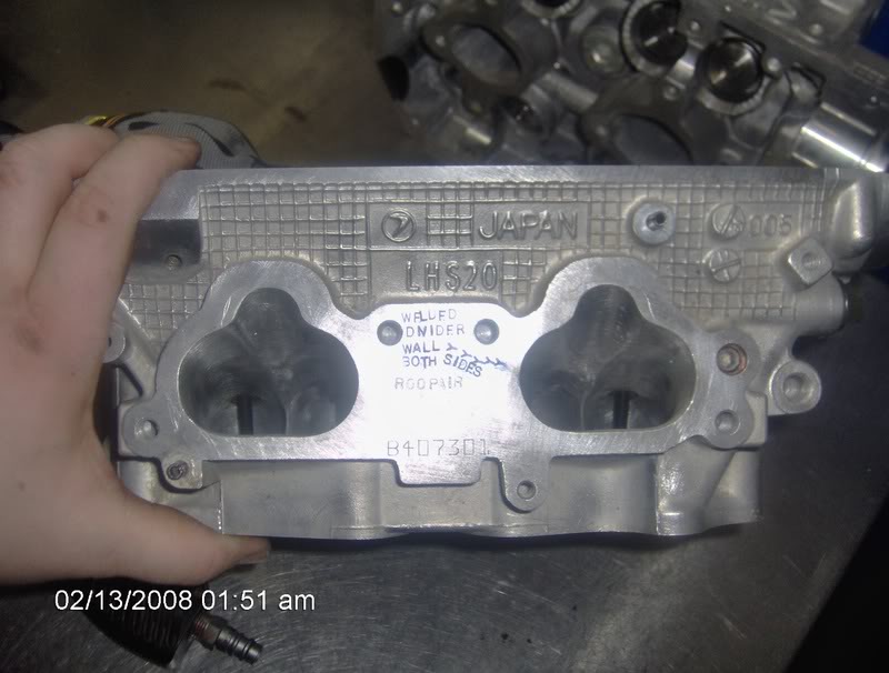

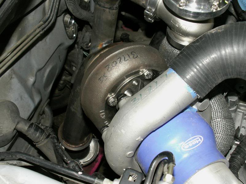

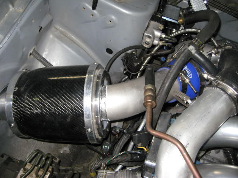

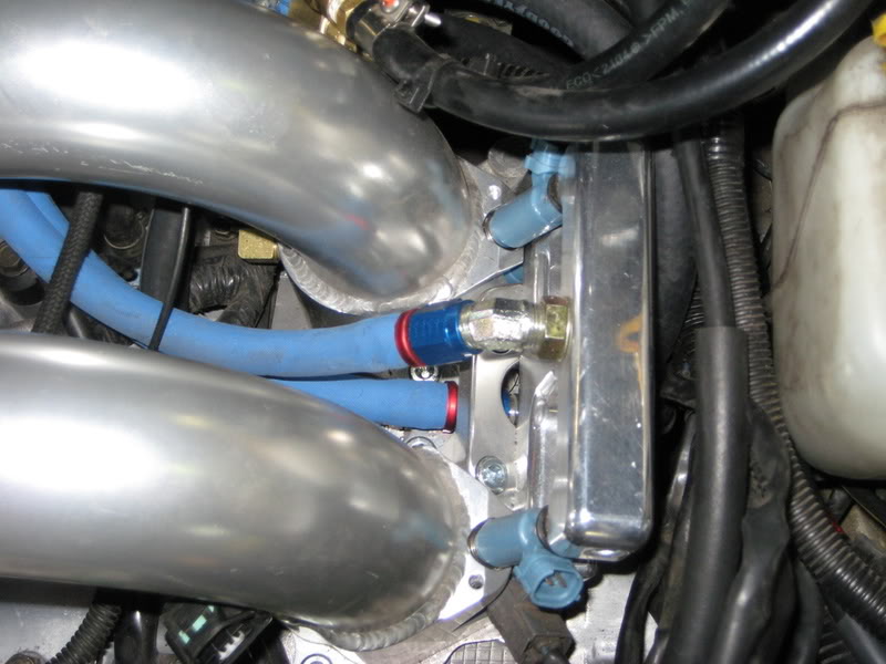

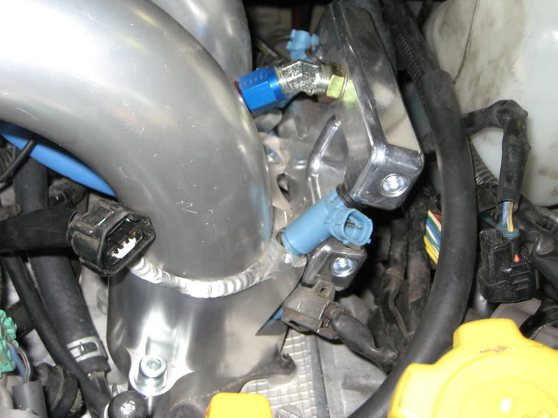

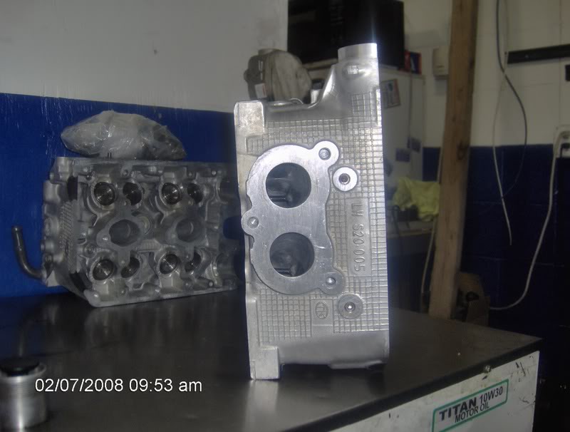

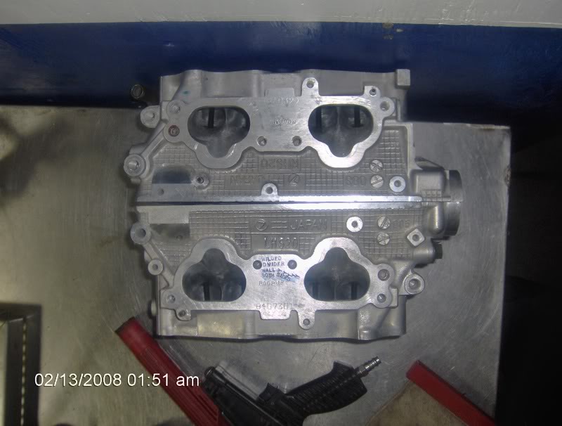

This is a fully built long block with 1mm over sized valves, chromoly rods, steel sleeved....ported heads, custom cams and much more! It has a Borg Warner S256 twin scroll, Forsa manifold, 8 850cc injectors, autronic....the list goes on and on...
We will be offering this entire package soon!
Compressor Wheel:
Inducer: 56mm
Exducer: 78mm
Extended Tips: 84mm
Turbine Wheel:
Inducer: 74mm
Exducer: 65mm
.76 A/R
Twin scroll

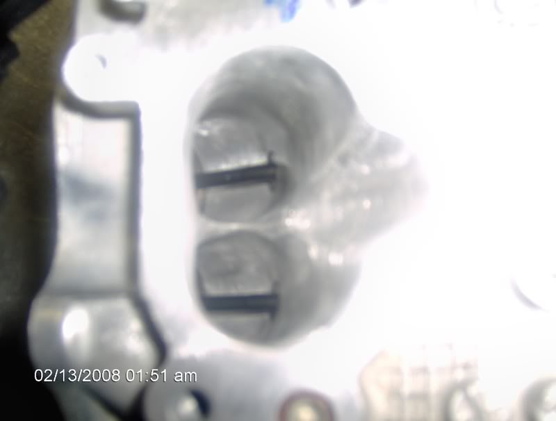

EJ20 Port and Polished, 10k Springs, Stainless Steel Valves, Titanium Retainers

Our Goal is around 550whp at ~3300 rpm and have it hold until ~7000rpm
Fingers crossed

We are 100% ready to start the car now...well once we get the Autronic and our Lap Top to talk to each other...it would seem they dated in college or something and have some harsh feelings....so we should have some Vids for you all real soon!!!
