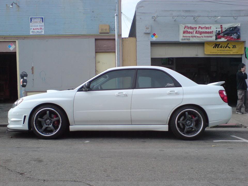

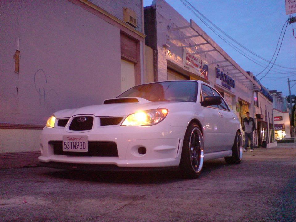

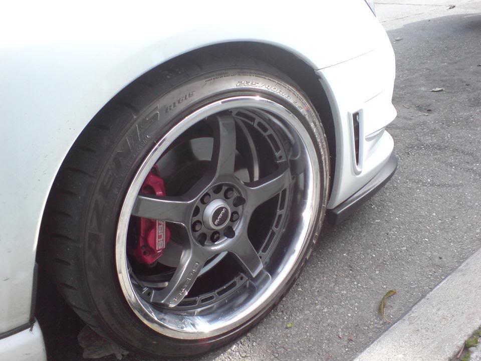

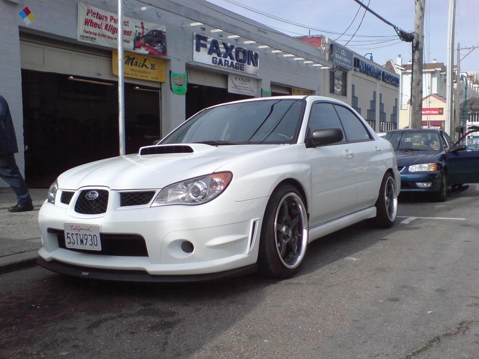

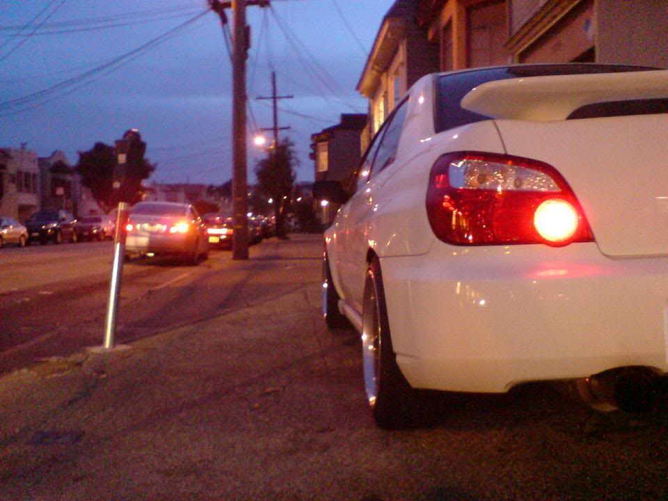

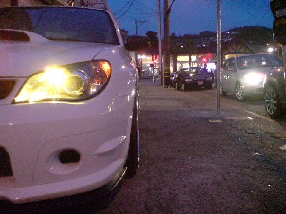

got my new wheels mounted, 18x9.5 ET40 G-games 77 Wolf 2 piece. car is running -2.0 camber all around with Stance coilovers, currently stretching on 235/40/18 Azenis RT615 and no rubbing. rear strut clearance is minimal at approx. 5mm, will bring down rear camber to -1.5 and try to fit some 255/35/18 some time in spring. Thumbs up again for MachIII for getting me the wheels! lost the battery for my DC so pics r taken with my camera phone, dont mind the quality

I would be carefull with the lip of the rim. It could easily get scratched. But nice job. Looks great.

Good to see a subie with a proper wheel and tire setup (although a bit stretched), seems to be a rarity on subies.

i have 235/40's on my 8.5's and i thought they seemed a little stretched. You need some 265's on that ****. Still looks good though.

looks great! watch the lips tho :\

did you have to do anything special to switch out the tails??
Old Dec 18, 2006 | 02:03 AM
ommmjido's Avatar
Posts: 1,698
no just plug and play
