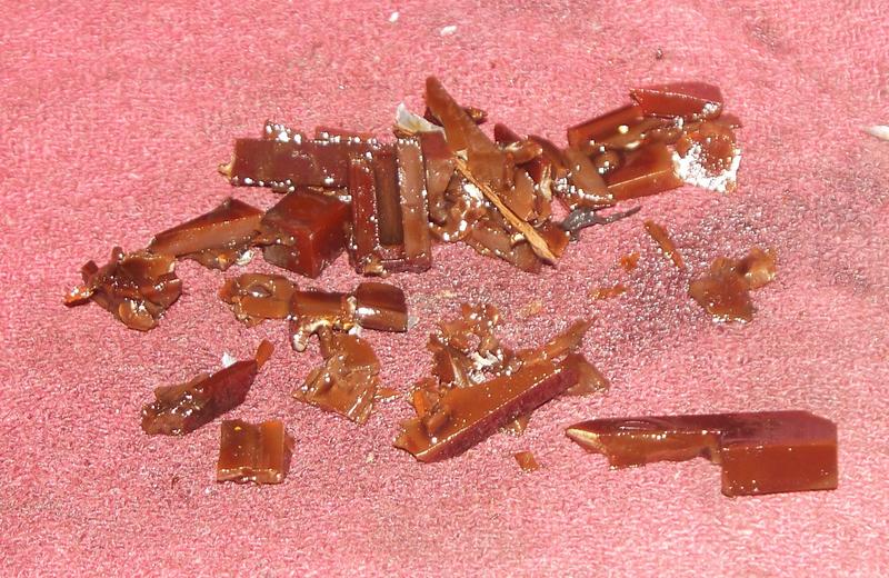

I had an earlier thread with more details, so I am sorry that this does not include everything thta lead me to think that it might be a thrust bearing and not the timing chain. However I did not think that the bearing was spun. Only that it might have what some call crankwalk.
Today I dropped the oil pan and Found these pieces of plastic. Has any one had a bad thrust bearing?-plastic.jpg
I found a picture on the internet of what the engine should look like, and I am pretty sure that the pieces I collected go together to make the guide shown on the bottom right of the picture. In two weeks my wife should have a quite smooth engine.
Now the car is at the mechanic having the timing chain guides replaced.
