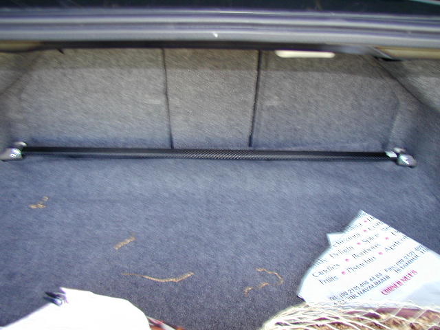

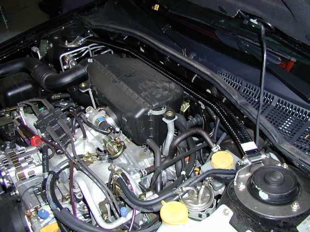

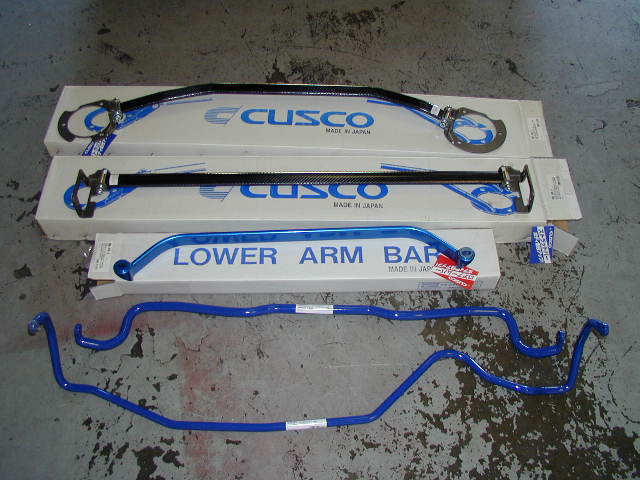

So, after doing a bit of research, I decided to get some parts from Japan and try to fit them onto my Legacy BE. Suspension was the first thing I wanted to address. And, no other company offers more suspension parts for the Legacy than CUSCO. Plus, since I am a loyal CUSCO customer, this was not a difficult choice to make. I got front and rear ALC-OS strut bars, rear lower arm bar and front and rear sway bars. CUSCO also makes a front lower arm bar, but I knew for sure that it wouldn’t fit onto a non-turbo Legacy. ALC-OS strut bars are basically a standard Type OS bars (oval shape) wrapped in carbon.

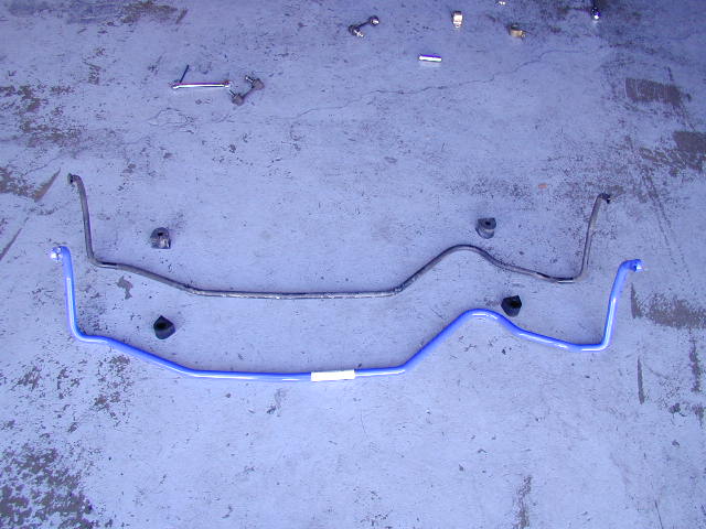

Rear sway bar is about 120% thicker than stock (18mm) and so is the front one (21mm). I started the project by installing the rear lower arm bar.
Rear CUSCO Sway Bar vs. Stock Sway Bar
Front CUSCO Sway Bar vs. Stock Sway Bar

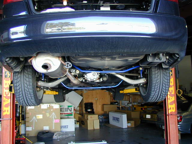

After 20 min of struggling to get it in, I installed a rear sway bar in 5 min. Front sway bar didn’t clear the header, so I couldn’t use it. I will save it for later and in case I do a motor swap (EJ20T or EJ20TT) I will be able to use it then. Then I installed front and rear sway bars and dropped the car down on the ground. The front bar bends nicely around the "imagenary" intercooler, or an airbox, in my case. The rear bar seats low to the floor, and does not take away any of the valuable trunk space. To my surprise, the rear lower arm bar was “hanging” too low. Not sure why, since the gap between the bar and the diff, was over 2”. That is totally unnecessary and it looks very bad when you stand behind the car. It almost touches the ground, but since it sits on the same line as the axels (and center of the rear wheels) it never will do that, unless you drive without tires. It looks so weird, that I am considering taking it off.

After making sure that everything was done correctly, I took the car for a test spin. Result: much better handling and dramatically reduced body roll. I wish that the front sway bar fit, since that would improve the handling even more. Oh well. So $845 (retail) later, I was very happy with my BE, more happy than I was before. Now that I already have rims and tires all the new CUSCO pieces, coilovers is the next obvious mod. I have chosen CUSCO ZERO-2 setup (of course) which should be here shortly. My goal of turning the already great Legacy into something even better is underway…

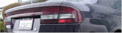

I got the taillights from Japan through go go go.
