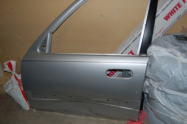

is this what you were talking about?
I need to know if I can separate that section you pictures. The inner structural area is whats damaged and I need to know if I can remove that part from the outermost painted panel so I can put the painted panel on a new structure

I am sure if you do A LOT of drilling, cutting, and welding it can be done. But typically that (what I have in the picture) is the minimum a body would replace.
