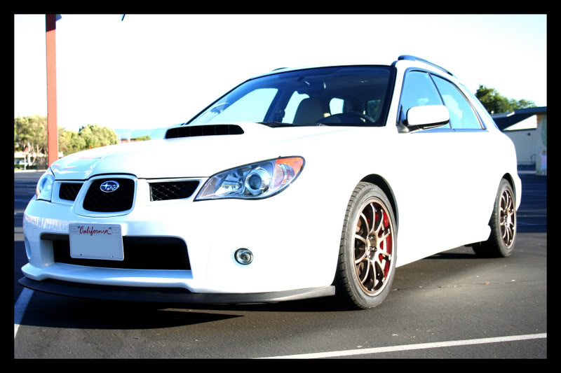

Car Info: 2006 WRX Wagon
Prodrive springs: no saggy butt here. 1st pic without lip, 2nd with lip. 3rd pic is overexposed, but you can see an even drop.

Hey Simonster...I recently bought chinese knockoffs from craigslist and their fine. But you gotta do your own drilling and use their supplied bolts and washers. I'll try to upload a pic sometime later today. It will run you about $125 for the s204 limited front lip wannabe...for only 1/4 the price of the JDM!
