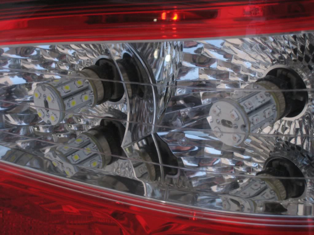

Haven't posted in a WHILE but figured I'd share...
Welp thanks to Big-E on here I went and took the plunge for the LEDS in the rear taillights... Just wow. Looks amazing and is brighter/faster than stock bulbs.
I will note that the camera I am using can not capture just HOW bright these are. It's awesome! The reverse lights are 5k and are PURE WHITE. Makes the stock bulb that are in the tailights look VERY yellow almost smoker's yellow tabacco yellow..lol

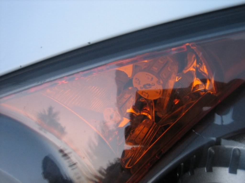

I got the 7watt HIGH POWER 20smd LED 7440/7443 bulbs. Got the plug and play led flasher relay from superbrightleds.com so that I didn't have hyper flash...
I think it looks good.
Also did my jdm turn signals in leds along with front turn signals. See all vids..lol

For it to work on an 04, one would need cleared out lenses I believe, otherwise it would always be amber anyway as you can see in the OP's last pic in the first post. Not sure about 06-07 Hawkeye.
