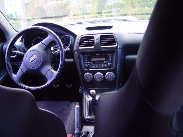

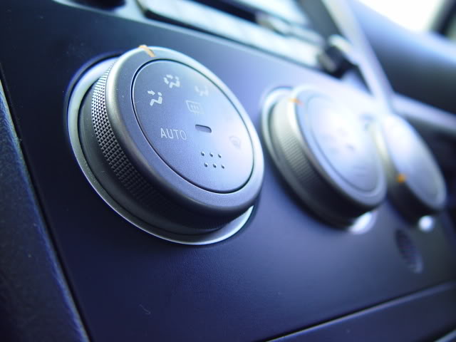

i just painted my 05wrx interior satin black(close to flat black but a lil more shine) it turned out great. the only difference is that my three **** face's arent black like the s204, ill post pictures tomorrow.

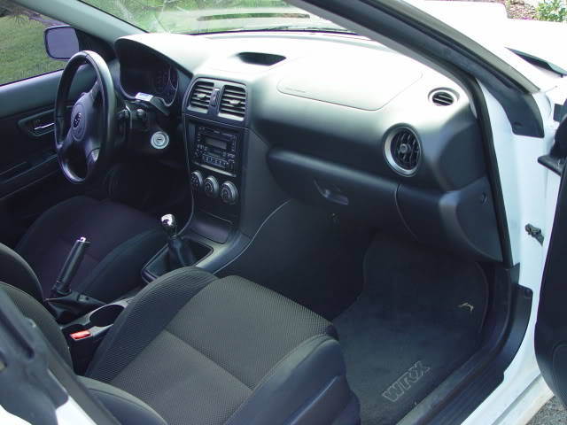

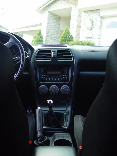

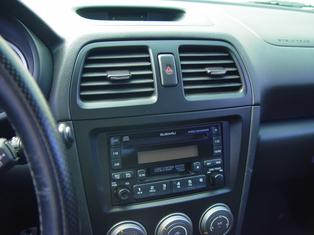

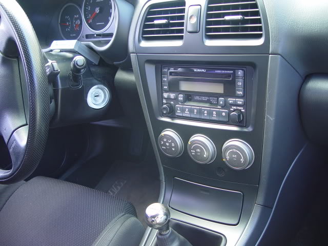

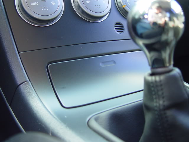

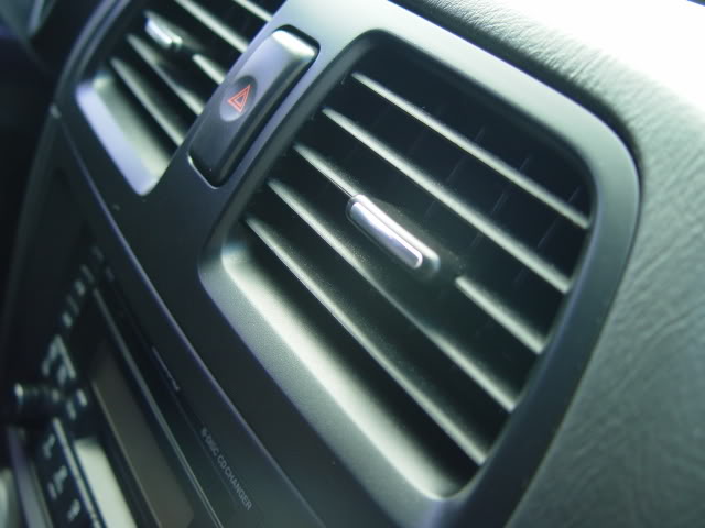

got the pictures in gijow.
05 wrx interior, painted black, OEM 2003 wrx radio, OEM 2003 hazard button.

Thanks, WOW! That looks much better than the flat black. I am trying to "class up" my interior and i know that if i make the wrong choice in say color i'll be doing the opposite. What brand of paint did you use? Did you use a sealer or primer? How about sanding? Thanks again for those pictures, looks good.
P.S. I have an RS, did those chrome handles come on your wrx or are they from an sti? I need some.

damn that looks sweet

brand: krylon interior/exterior fushion
color: semi-flat (i think this would be the best color, i tried using gloss black...yuk, flat black is too flat for my taste.)
primer:none, i got too cheap to buy some, so i just took 220grit sand paper, and scuffed it up a lil.
sanding: i tried doing like 4 layers, then sanding. for some reason it made the paint lighter/screwed up looking. i did NO sanding at all. the paint is so good i didnt need to sand.
took about 2-3 hours.
my chrome door handles? - came with the car.
