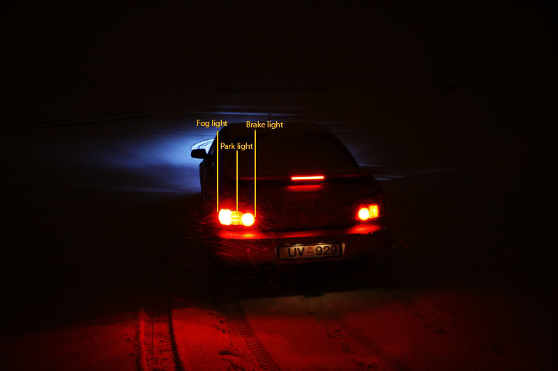

haha do a search on i-crub!
https://www.i-club.com/forums/showpo...8&postcount=18

It really shouldn't be that hard. Wire a switch to a relay that powers the feed to one of you rear brake lights. Pretty simple actually.
