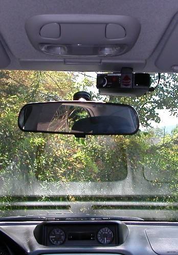

Just wanted to post a photo of my Valentine 1 that I just installed...you can hard wire your detector into the map lights (there's actually an empty plug up there for the automatic dimming mirror even if you don't have that option). The yellow wire with the red stripe is switched 12v power (i.e. only on when the key is on) and you can ground to the black wire or to one of the screws holding the map lights in (pop out the clear plastic cover and inside are 2 screws holding the map lights in)...If you take off the center visor and remove the clip holding up the headliner it makes running the wire to the detector easier...that way no wires running in plain sight to your detector.
I installed the V1 with the visor clip adaptor and it is actually over the headliner...sits pretty securely and can still remove easily for use in the other car...

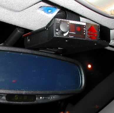

This is how I mounted mine. I have the auto-dimming mirror and with the detector mounted as shown it just sits on the top of the mirror. I have velcro on the bottom of the V1 (the fuzzy part) so it doesn't rattle against the mirror, I suppose I could attach the grippy side to the mirror to hold it in place but I never bothered.
I removed the center visor completely, and mounted the V1 visor bracket directly to the roof using an existing push-pin that holds the headliner in place. All I had to do for this was drill a hole in the clip part of the bracket (not easy actually, that spring steel is hard to drill through). The detector attaches and detaches from the mount in seconds, it's very convenient.
In the pic that exposed blue area is very obvious, but I don't even notice it anymore. If it bothered me I would find something to cover it up.

Works great, it's been up there for over 1-1/2 years and hasn't moved or loosened. Those pushpin things are very strong, and they're pretty much one-way, very easy to push in but near impossible to get out. It didn't come out easily when I removed it and now it's in there to stay until I decide to try taking the mount off for some reason.
Oh yes, it helped that I had a spare visor bracket to play with (from having traded my V1 in on a new one) so in case I ruined it I still had a good one to use.

How I installed it...
I used the sun-visor clip adaptor to hold up my V1...it's hard wired into the map lights...in the map lights there is a wiring harness that's empty if you don't have an auto-dimming mirror...the yellow wire with the red stripe is switched 12 v power (goes on when the key is on...)....the ground can be either one of the screws that holds up the map lights or you can hard wire into the black wire from the same wiring harness...
To take the map lights off you remove the clear plastic cover with a flat-head screwdriver (protect with a cloth) at the 2 slots you can see...once that pops off if you look in there are 2 philips screws holding them on - take them out and the map lights will fall out...yo can disconnect them from their wiring hanress to get them out of the way...up top you'll see the other wiring harness for the mirror...that's your target...
Then remove the center visor by unscrewing the 1 screw holding it up...you need to do this to mobilize the headliner to run the power wire to the V1...there's also a plastic clip holding up the headliner under the center visor...so remove that as well (I used needle nose pliers)...once removed you can pull down the headliner just enough to run the power wire out to the V1....I also used this to pull the headliner down enough to put the hanger up for the V1 - simply clip over the headliner over the right side of where the visor should be....doesn't have to be in exact position as you can still move it once everything is back in place...
So once all the wiring is done (there's PLENTY of space for all the wires up next to the maplights)...put the maplights back together (make sure you've adjusted the wire for the V1 coming out of the headliner to the desired length first!
), and reinstall the center visor....I then put a small block inbetween the center visor and the V1 adaptor to level it (that's the black thing you see between my V1 and center visor...I have since replaced it with a large silicone 'foot' for the bottom of furniture...)...
The cool thing about this install is I still have the suction cup hanger and cigarette-lighter adapter for use in my other cars when I drive them, and I can just leave the V1 on all the time in the WRX as it comes on and off with starting the car...

RHK 118: I finally got around to installing my Valentine 1 and everything you said worked perfect ! You are high on the thank you of the day list. Thanks so much for all your detailed instructions, My V-1 saved me the first day on the job ! Thanks again.
