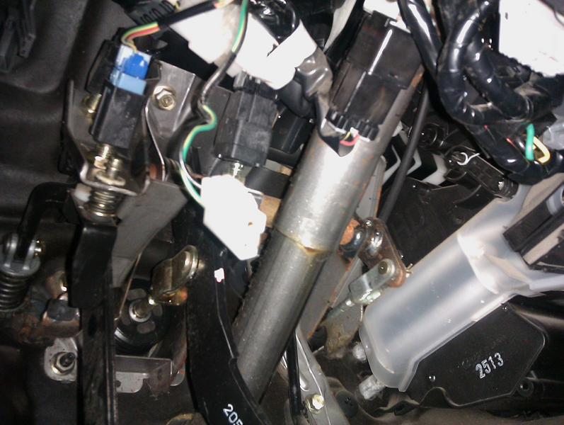

Hi folks....just wondering if anyone can identify this green wire under the steering column. I was looking for the green test connectors thinking if they were still connected, this might be why I only have 6-8 psi boost. The test connectors were disconnected and to the left of the steering column (im pretty sure cuz there were 2 of them). What i did find was the lone green wire. Its wierd becasue in the slots is a piece of copper wire from one slot to the other...like a resistor mod. When I plucked out the piece of wire, the car wouldnt start. All dash warning lights light up when I turned the key, but thats it. I put the wire back in the slots and whallah, car started right back up.
sorry...its hard to see the lil copper wire cuz of the flash on the camera...but its there.

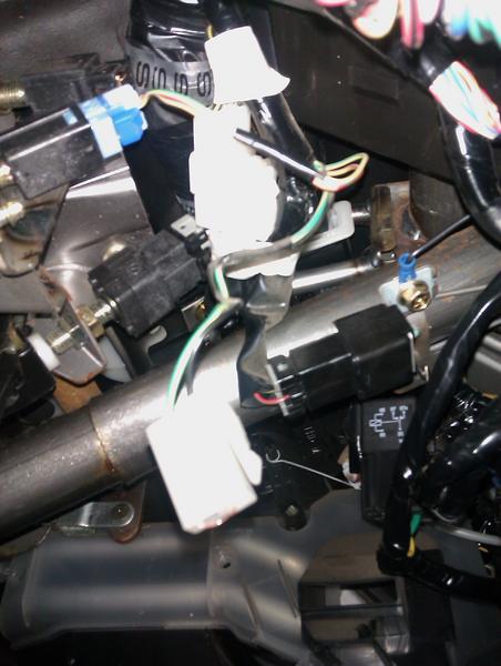

Yes, but I see 2 green wires off to the left, this one is more in the center. And why does it have this flimsy piece of copper wire in both slots ? I'll try and take another pic in the sun not using the camera flash.
That is your clutch safty switch. It is the switch when the clutch is depressed all the way down. To check and see for sure, make sure your car is in nuetral and dont press in the clutch and see if it starts.
The picture is not totaly clear but if you look at the top of the clutch pedal you should see two switches. It looks like the top one is not plugged in, hence that is this green wire. Alot of people do this because that darn switch always craps out. I've had 3 subys and every one of them did it after some time. Senario: Press in clutch and car wont start. Press clutch all the way down a couple of times and bam, fires right up. People do this instead of tryin to replace the top switch which is a PITA to get to.

Are you the original owner? was there a aftermarket alarm installed on the car before? like Chris said it might be a clutch bypass type thing. And if you had a alarm with a Remote Start and removed that might be it.
Joined: May 2010
Posts: 91
From: San Francisco
Car Info: 2002 Subaru WRX
Im not the original owner...I wish I was, then I'd know what the hell is going on with the car. There is a Clifford alarm on the car, yes. No remote start though. The jackass who worked on the car last lost my remote, maybe this was part of his fix. iono. Thanks 4 the replies !!
