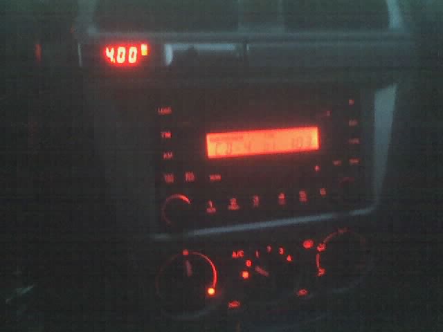

here's my radio and hvac that is done. unfortunately i couldn't shave enuff plastic off of the super bright 194 led's to fit in the hvac, so i used #74's in red. there is a little bit of dimming to either end (right & left) of the hvac so i painted the stockers and i'll put them in tomorrow when they dry..
peace, dub.

pretty cool. did you have to open up the radio and hvac??? and where did you get the bulbs for it??? i know you can do it for the cluster i am very curious how you did this? thanks

the radio you have to basically disassemble. the hvac comes out when the radio is removed and there are two bulbs behind it. i used a combination of bulb covers .10" (www.partsexpress.com) and red led's for the hvac found at (www.superbrightleds.com)
the cluster can be done, i forgo'ed doing mine b/c i'm selling/ trading the car for an '05 sti. you have to complete remove the cluster, sand all the green film off behind the cluster it self and cover all 6 (i believe) bulbs with covers.
most important!! there are many stickies on i-club as well as nasioc about this subject. all with detailed instructions and pictures provided to make it as easy as can be - which i might add it is really easy to do this mod.
