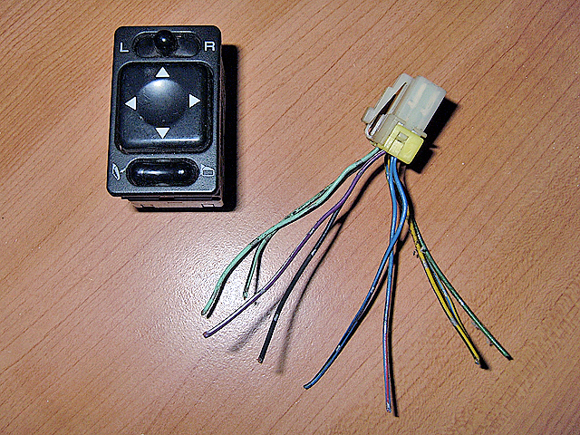

Anyone know how to wire these up?
I have the switch with the harness end. I know that there are an additional 2 wires per mirror for power and ground. My question is do I just run the wires from mirror to switch or do I need to do something else? Since I Have the original harness end from a car that was wired with these it would be awesome if I could just route the wires just to the switch.
LMK
Jon

i figured it out a long time ago. thanks though. that link didn't help as much as i wanted it to since it was for the GC body style and the GD body mirrors are different but technically the same concept.
this link IS for the GD body style and is pretty detailed. I used the wireharness pictured in my original posting and used a large sewing needle to take the pins and wires out. Then when those were out I slide them into my cars harness and that completed the wiring at the switch side.
Step #9's wiring description needs some help since you won't find a separate brown and a separate red wires (since it reads that way). You are ONLY connecting TWO wires so it needs to be read Brown/Red wire and not Brown AND red wire.
http://www.ghettoengineering.com/mirrors/
Thanks,
Jon
