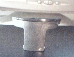

Hi... this is the USDM mask i made for my JDM lights.
I cut off about 3/16in off the top of the JDM mask.
Then fabricated the top portion (with US pattern) out of steel (lots of grinding).
Then painted the top of the US-top with flat black high temp paint.
Finely ground a Maskbody to fit 1 of the US Masktops.
Epoxied (i used an epoxy with a temperature rating listed: 300F, cuz it's all going back in the oven).
The oven is warming... and so i took some pics of the final piece before it's locked away... FOREVAH!!!!.
I also have some pics of the maskbody and maskhead before epoxy and glue.

got any after pics of the actual beam? how did u "fabricate steel" onto the mask?
