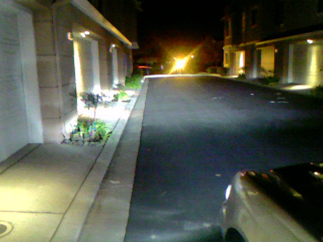

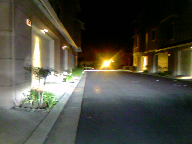

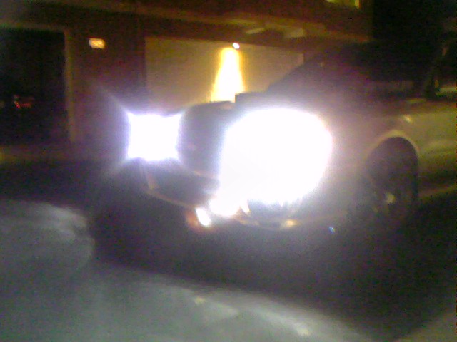

By the way, if you want an HID kit that works well. I might be selling my 8000K Bellof kit soon...
Attached Thumbnails HID Kit-wrxhid3.jpg   HID Kit-wrxhid1.jpg   HID Kit-wrxhid2.jpg

The label said 8000k. But they aren't that cheesy deep blue color that alot of the cheapo 8000k kits out there seem to look. It looks alot like the PIAA 6600k. When it fully warms up, the light on the road is a crisp whiteish purple. But when you look directly at the headlights...this is what they look like.
