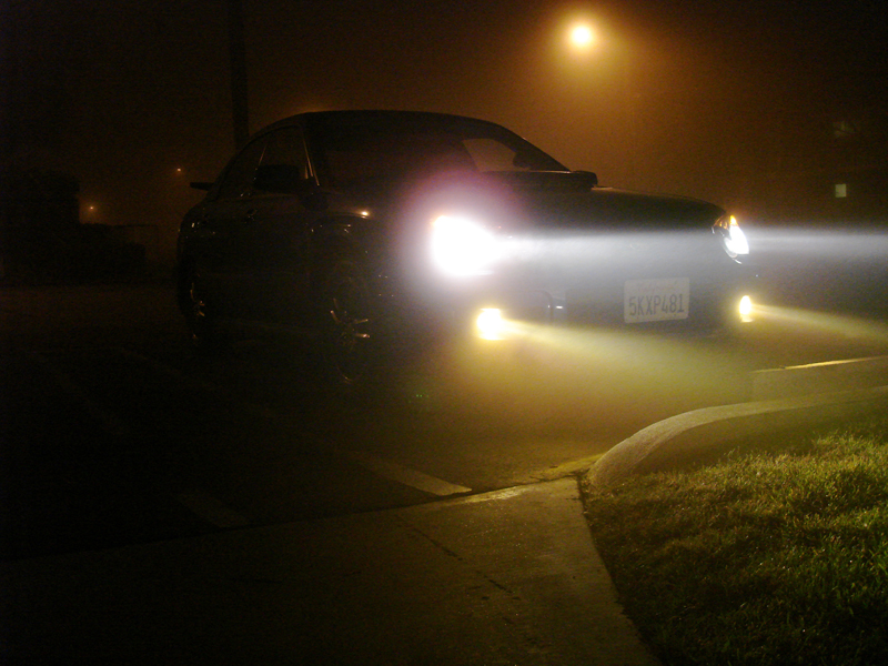

on mine i just pulled off just enough of the plastic under cover to get my hands in. the assembly is the pretty much the same as your headlights. took me about 30 to switch out lights.
