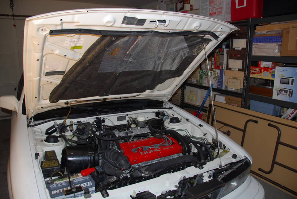

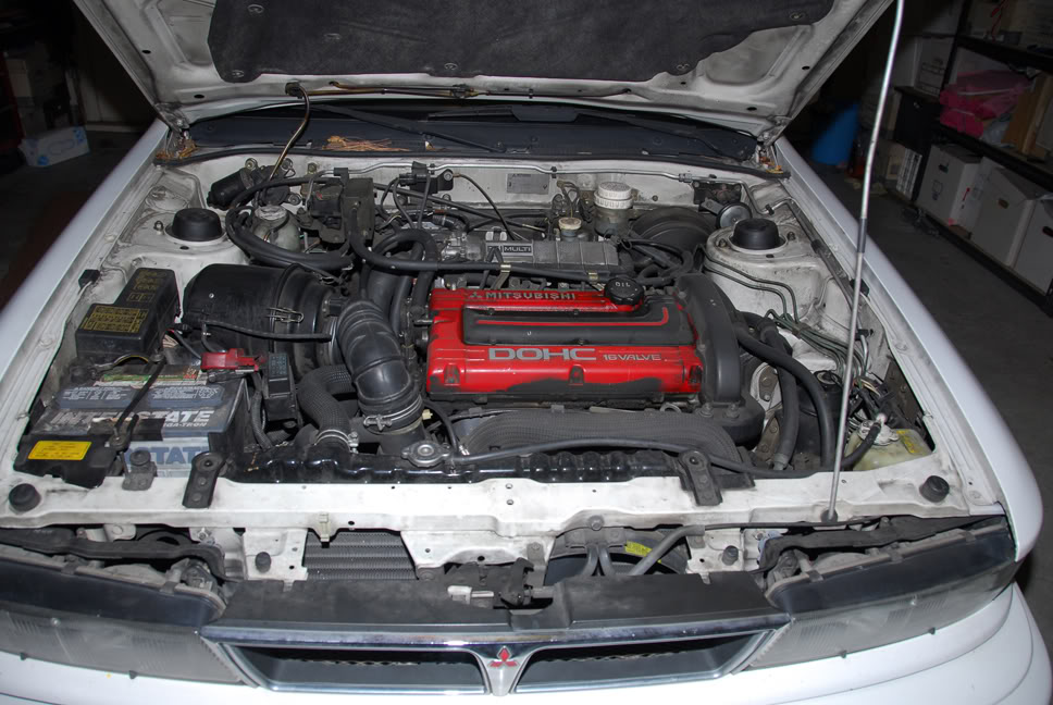

dynamicprojeKtz's Avatar
Posts: 2,370
From: Livermore, Ca
u b d judge
