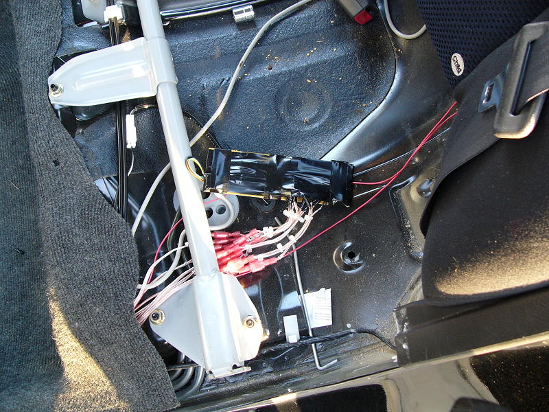

I've been working on an idea for computer engine management... This is what i've gotten so far.
I mounted a P4 computer where my spare tire usually is, added venting, shock absorbing material and ran power to a power converter under my driver's seat.
Took apart the converter, and ran switch and LED wires to convenient spot by steering column (by fuse box). Ran power thru firewall to battery with fuse interrupt. POWER!! Whoohoo! :banana:
I already had a Panasonic slide out/tilt monitor in-dash setup, so i ran s-video out into the Panasonic brain. VIDEO!! Whoohoo!
Have sound coming out of computer into brain as well. SOUND!! Whoohoo!

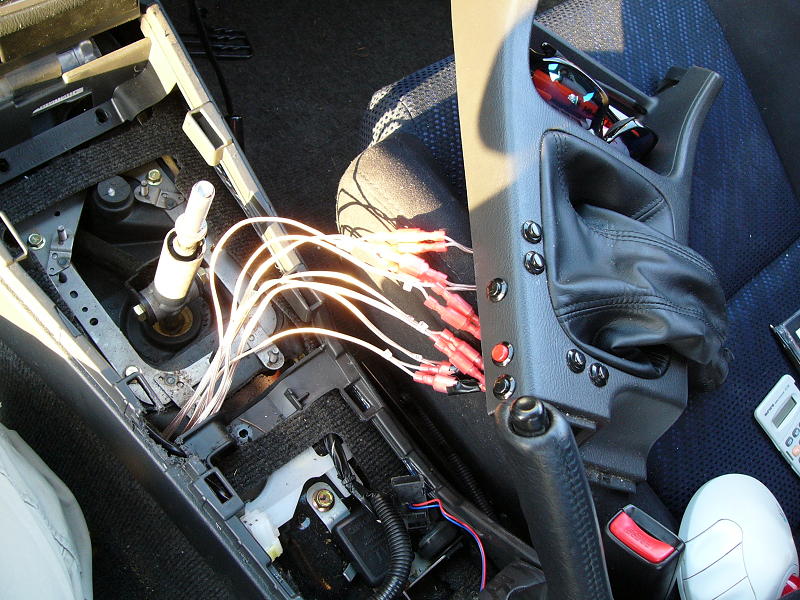

THEN i took apart a USB Keyboard and re-wired it, so it only had 7 keys. Up, down, left, right, tab, alt and enter. Plugged USB into computer, and bought custom pushbutton switches from Radio-Shack. Dremel-ed holes by shift boot, and ran wires from keyboard chip to the switches. BAM! Custom Keyboard. :banana: <--- Little played out eh? hehe
Here's pics of the keyboard setup. Black Shrink wrapped thing is Keyboard chip. Wires running out of that under floor. Mounted under rear seat bar. So no fatties will squish it. hehe
Have a trackball mouse controlling right now, but ordered custom touch pad mouse that mounts by e-brake and swivels up for sexy factor. Yup.
