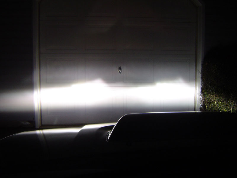

I have HIDs in my 04 and they are perfectly fine.
Did numerous tests of my friends driving towards me on the other side of the road to see if any glare or anything and he said, just like normal HIDs and doesnt blind oncoming traffic.
When I installed mine, I had to play around a bit to make sure the bulbs were fit properly since the pin is the main thing holding the bulb in.
Everything above the cutoff is glare. If you are lighting street signs up from 3 blocks away, that's glare. I have the same beam pattern and it's unacceptable. Just because your friend can tolerate it, doesn't mean it's good. Note the last picture from my last post, that's what HID should look like, 0 light above the cutoff.
